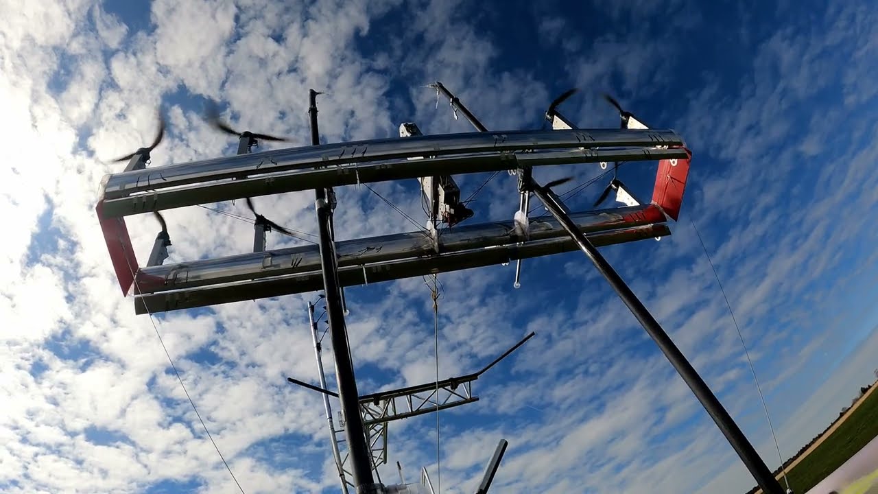

Not really sure if I saw some propellers on the top of the two sticks to control pitch doing hover.

If this is a prop/generator blade combined design, it would be interesting to hear what performance expectations Kitekraft had with this device

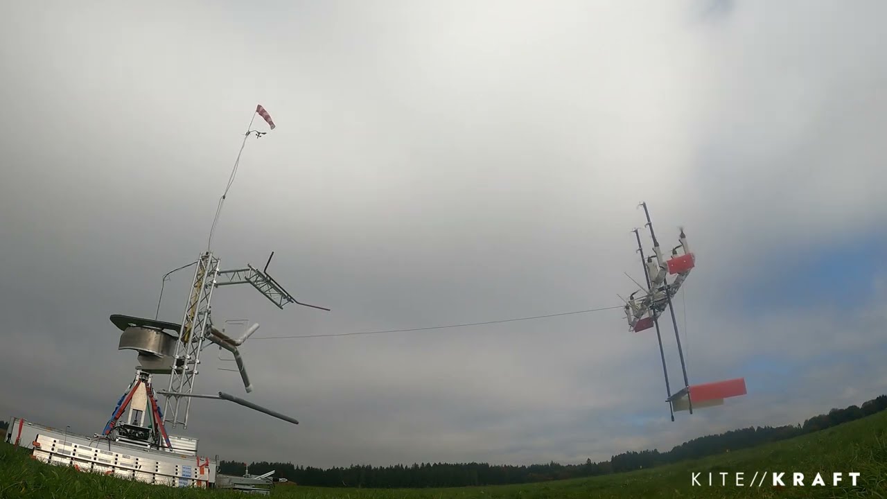

It seems they are flying stably.
The video shows a little bit how hard this is. Because once you have stable flight, the next generation of problems show up.
I see a wobble in flight that is probably detrimental to performance.
Also the angle tether vs main wing is so large in the turns that you canât expect it to be possible to fly smaller patterns. This is not a problem per se, just seeing that a design freedom is at itâs limits. And with larger scale and square-cube mass scaling, the pattern would be relatively bigger, increasing cosine losses.
Still, a good achievement from Kitekraft. This is a long flight, more than one hour and with takeoff and landing. Bravo!
Looks like it was able to handle a wind shift backing from (Guessing) North to West
What surprises me is the relative large size of the gen/prop blades vs wing area

Another recent video:
Uncut Flight of Kitekraft Demonstrator - Tail Cam
Kite size: 2.4m wingspan (1:4 scale).
Location: Oberbiberg near Munich, Germany
Date & time: 24 July 2024, around 4 pm.
Wind speed: 1âŠ4m/s from west. (This is below the cut-in wind speed and thus too little for net-positive power generation. A product-version kite would remain on ground and wait for stronger wind.)
Name of kite: SN9 âEserâ

I would also like to hear the sound (when stronger winds occur during tests) which is a simple way to communicate approximately the evolution of the power during the flight within this large (compared to the wing size) figure-eight path.
Wow, ask and ye shall receive - Thanks Pierre.
Now Iâm not sure why they are calling this video âTail Camâ when it was a downwind view from proximate the base station, versus the previous video having featured a âTail Camâ.
And the date given: Date & time: 24 July 2024, around 4 pm - is 11 days in the future even from today - huh? Possibly confusion generated by the European way of writing dates?
It does seem like my suspicion of no power actually being generated might have been true for the previous video, since that is what they say about this video - winds too light for power production.

Some information:
About rotors:
Kitekraft system proves full control authority during hover in high winds.
The second batch of test runs focused on mapping the performance of different rotor configurations, shown in the image below. On the left, one of the CFRP rotors is shown which were optimized in-house. These rotors consist of different symmetrical airfoil cross-section and were optimized for the motoric as well as the generative mode.
On the right, one of the currently used, off-the-shelf injection molded rotors with two blades is shown. This rotor was also tested in stacked configurations, using two or three of these two-bladed rotors at the same time, resulting in a four- and respectively six-bladed setup.
Left: CFRP rotor, designed with Kitekraftâs in-house optimization. Right: 2-bladed off-the-shelf rotor, which was also tested in stacked configurations.
All rotors were tested at speeds of up to 8000RPMs (tip Mach Number of around 0.54) and various airspeeds. The CFRP rotors and the six-bladed configuration of the injection-molded rotors already generated the same thrust at lower rotational speeds, which is beneficial for noise reduction. While Kitekraftâs systems will definitely be fitted with customized rotors in the near future, such a stacked configuration could be used as an economic shortcut for improving the performance and reducing the noise emissions of our current demonstrator immediately (see also: How to Develop Flying Wind Turbines Quickly and Cost-Efficiently?).
The efficiency of the in-house designed rotors is over 80% - a very good performance.
The efficiency of the CFRP rotors was measured with values of over 80%. This is a very good value and stands as proof to Kitekraftâs in-house optimization algorithms, which will be of great value for the design of future system sizes.
To sum up, the conducted tests and findings made mark a significant milestone in the path to a rugged flying wind energy system. Firstly, it was demonstrated that the kite can hover stably for launching and landing in high winds. Secondly, it was shown that Kitekraftâs newly optimized propellers performed efficiently.
