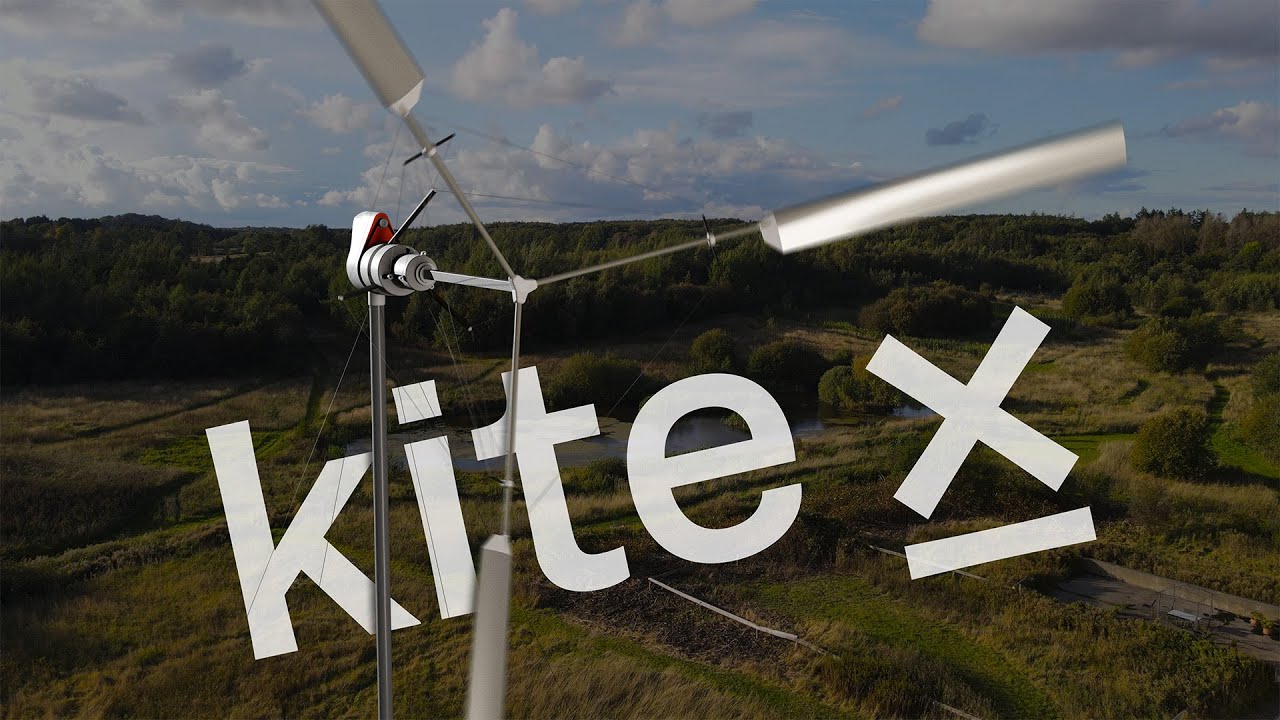

Looks like the overspeed protection works pretty well.
KiteX TWT-11 “Aero” Husstandsvindmølle (in Danish)
It’s unusual to see an AWE company produce anything remotely resembling a regular wind turbine. For this model I will note some pros and cons:

The video shows a stable rotor speed of around 60 RPM, controlled by our active pitch system, with pitch adjustments up to 8.6° to regulate loads while producing up to 4.2 kW at under 7 m/s.

Storm Dave visited Denmark over Easter, and TWT-11 delivered as designed. At average wind speeds of 18 m/s - gusting 27 m/s - the TWT-11 kept delivering power to the grid.
Handling 18 m/s with a swept area of 89 square meters is difficult, but the TWT-11 does that with a total weight of just 326 kg!
The advanced aerodynamic and control platform kept all loads in check ensuring both safety and longevity of the system.
Sounds like you are doing a good job with overspeed protection. As I’ve often said, overspeed protection is not the main thing, it’s the ONLY thing!
