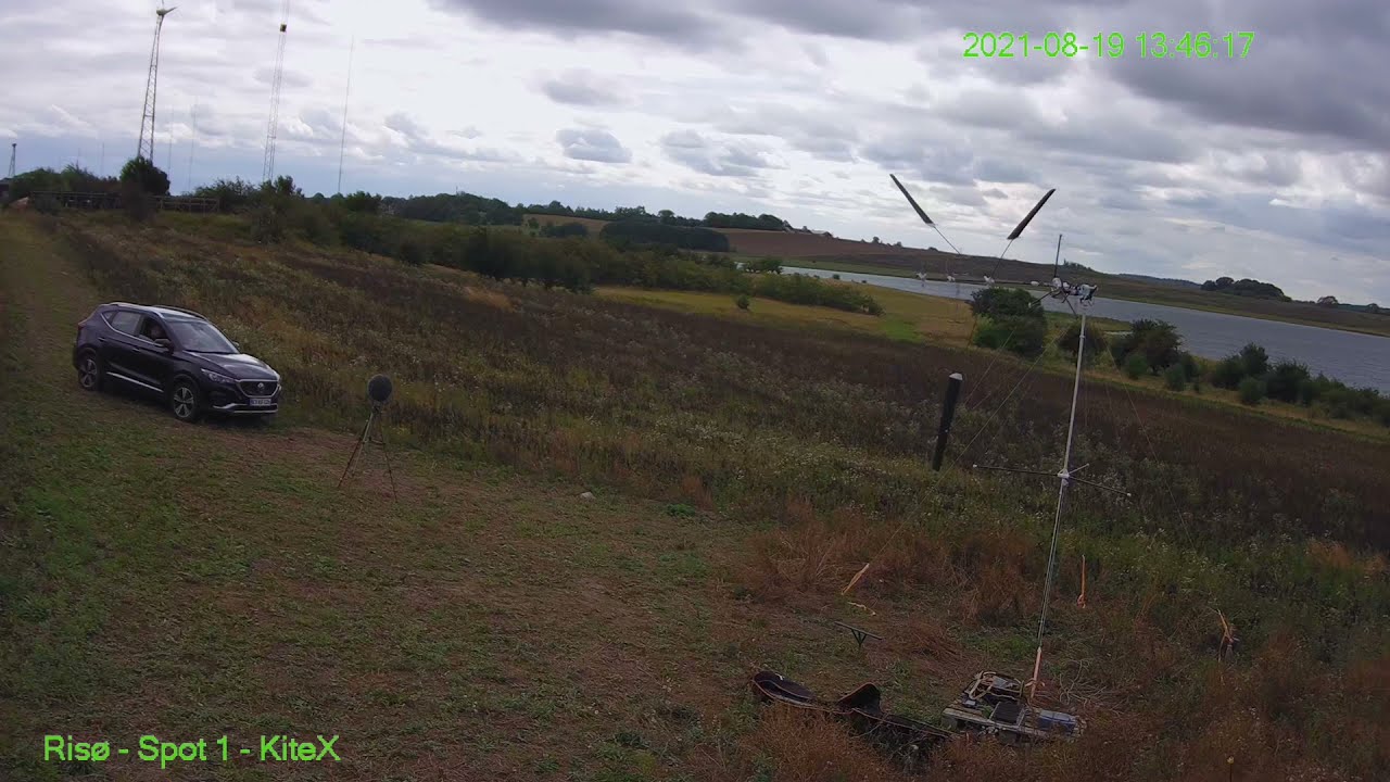

There is a bit more information about our power control strategy. Seems like we will go forward with a string/tether actuated pitch control system. The system also features a cyclic pitch components that help offset the adverse effect of wind-shear.
We have started to work on getting the edge case of the controller to work, which I hope is a good sign :slight_smile: . Still there is work to be done testing the system robustness in adverse wind conditions: turbulent +10 m/s, high wind shear conditions.
We had good winds for the past two days in which we were able to test the high wind performance. We are currently quite happy abou the mechanical design.
If anything the main complain I/we have is that the rotor isn’t able to handle high torque at high pitch angles. Secondly the blades vibrate/flutter due the the geometry when the blades are pitch to ~90 degree in 10+ m/s gusts.
Nice video @aokholm Andreas
What was it that tripped the pitch to change at ~1min 10 sec?
It was certainly whipping around at quite a rate until that point.
Nothing too exciting. It was just us who decided that it was time end that part of the test.
In the general case the only condition we have atm in the automatic control is if the pitch set point goes above ~25 degree, then the turbine will automatically go to cutout mode.
It might be that we make the turbine rotate slower, by reducing the aerodynamic yaw stability by decreasing the cone angle. This does however decrease guy-wire clearance.
