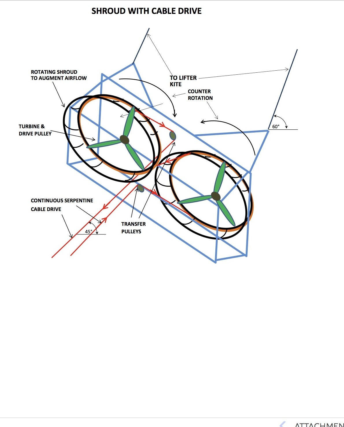

If we try to scale up Kiwee, then the size of the turbines increase and their optimal rotation speed decreases. In order for the cable drive to work satisfactorily, we need higher linear velocities of the cable. This will result in lower tensions in the cables and therefore thinner and lighter cables. Different sized pulleys can be used and substituted for a gear reducer, which greatly reduces the weight of the airborne system. We therefore need a large pulley at the turbine and a small pulley at the ground generator. It occurs to me that this large pulley can be used for other purposes in the device. Firstly, this pulley can be firmly attached to the tips of the three blades of the turbine. This will stabilize the blades and make them much stronger. Secondly, part of the pulley could be shaped in the form of a shroud, which could direct the air towards the blades, and improve the efficiency of the device. (See diagram). Although this pulley/shroud system will increase the weight of the device, it also acts as a flywheel which tends to keep the RPM constant.
I feel that the Kitewinder system is truly different from all other systems for the main reason that the turbines are oriented to face the wind directly, therefore eliminating cosine cubed losses. It is the only system that can operate at high altitudes without incurring these losses. For some reason this system has not been discussed in any of the high altitude wind reports.
The Kitewinder is a static system, which would involve minimal land area if multiple systems were placed next to each other. My concept is to eliminate the reelout/reelin function and use auxiliary lines attached to the lifter kite to launch and land the system where the tether is always fully extended.
This would be an interesting experiment. Unfortunately I can’t find it on the site - only the water drag generator.
A few thoughts on it:
  • The large rotor pulley can even be smaller (e.g. 1/3 - 1/2 rotor’s size). That would allow increasing the blades with less drag&weight penalty than a shroud
  • Pulley alignment would be tricky, preventing the rope skipping off it (e.g. during launch/landing) even trickier
  • Launching it alone without human hands involved is tricky too.
  • The pulling rope is better kept above the return one. In image this is reversed - this isn’t ideal since the return rope has lower tension, therefore more sag - if it is on top the two will eventually cross and wipe each other - that friction between pull and return lines will chew it slowly.
