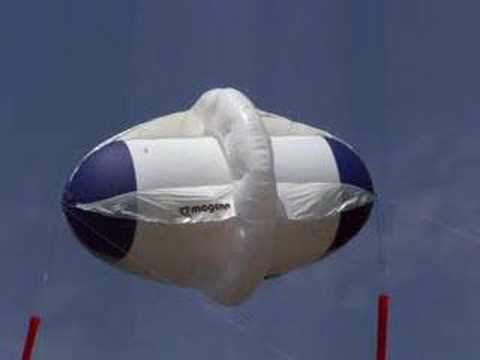

Savonius-like turbines have been a starting point for some AWE pioneers like:
Hi Pierre: yeah, I think they raised something like $7 million over this boondoggle that was the poster-child of AWE for a few years!. ![]()

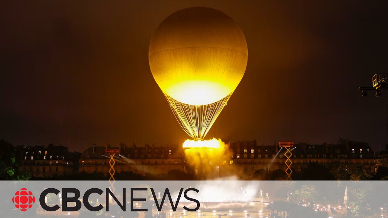

The Paris 2024 Olympic Games revealed the cauldron that rises under the tethered balloon.
The Olympic flame is in reality simulated by water misters on a multitude of LED bulbs.
The tethered balloon was imagined by Aerophile (following links 1 and 3 in French):
