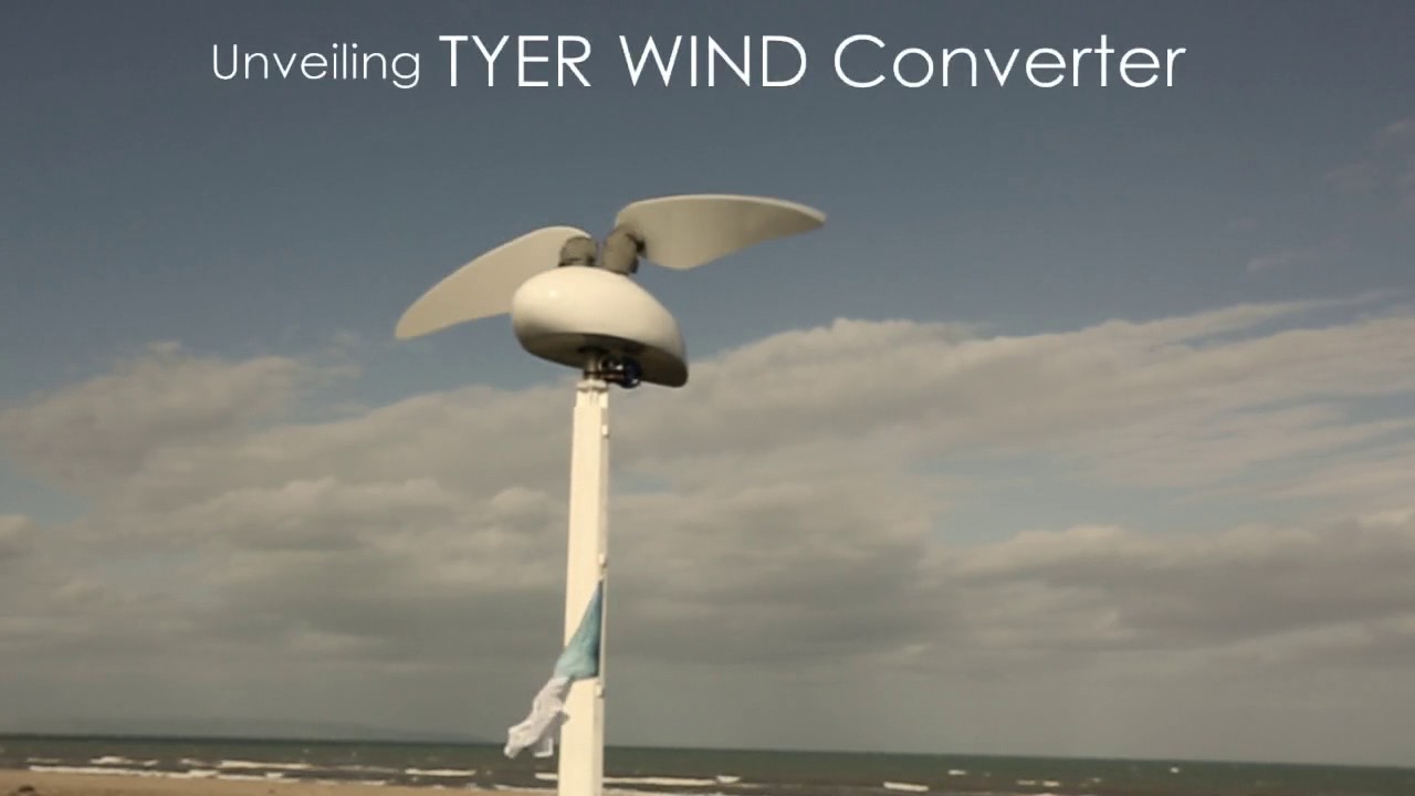

3D Aouinian kinematics
Does anyone know about tyre wind converter?
I am unable to find this 3D Aouinian kinematics
Aaahw… no…
On the surface of the idea I immediately see some issues:
  • very small swept area relative to wing area
  • the wings are not moving fast in crosswind direction
  • the conversion of energy from this movement seems difficult from a mechanical point of view
  • energy produced is not continuous. The problem with this is mostly a lower average power yield
  • how can this design have a huge wind range
  • there may be problems with wing stiffness in larger scales
Though winged flight like this is interesting, personally I dont find this design has much potential for power production.
Thankyou sir for your insights
Dont stop looking at the crazy ideas though. Suddenly you might find something interesting. I just dont think personally this one is a good start. There’s a certain chance I’m wrong as well.
