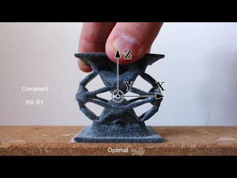

I think all AWES will have to plan for flexion
Compliant mech designs for the full structure deformations we’re looking for… are complex.
I’d suspect we’d see them first as linkages between blades and rims before becoming skeleton designs placed inside an epoxied rigid skin mould, injected with foam… sorta designs.
