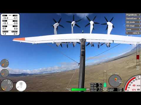

I had already mentioned the weight issue of the Makani M600, nullifying a positive production average for a wind speed below about 11-12 m/s (see other videos on https://www.youtube.com/playlist?list=PL7og_3Jqea4VRCZmMNK4LDH64sYgkLZzv):
