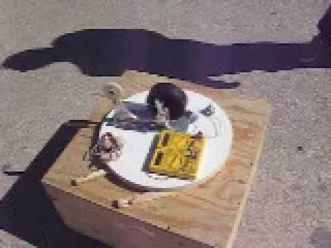

Just to clarify: A Voltage is just a potential. Establishing a voltage is not the same as generating power. You can put a voltmeter on a car battery and see ~13 Volts, but there is no power being used, just Voltage measured. Electric Circuits are analogous to hydraulic circuits (plumbing) Voltage is like water pressure. Current is like volumetric flowrate. Hydraulic power is pressure times Volumetric Flowrate. Without a flowrate, there is only pressure, which could be a pressurized tank just sitting there doing nothing. You could measure the pressure all day long, without making any power whatsoever. But at least showing one meter with something on it is a start! If someone said they saw 12 Volts, could that be just a measurement of the charge state of a battery that someone is hoping to charge into? ![]()
This picture on itâs own canât hope to tell the whole story which it is part of.
I think this was from a video I saw.
If Iâm right⊠The blue and white arm part was reciprocally pivoting from the wooden base. Think the black part was a wee motor/gen. The line pumping motion was from some unstable kite configuration. Can only have been making ~30W.
Thatâs already a load more info than the tiny picture from the tiny video relayed.
None of the test data from those experiments was (as far as I remember) presented cohesively, cleanly, supported with design diagrams, operating principle, descriptions, âŠ

In order to show power output, you need either a dedicated power meter per se, or two meters showing Voltage on one and current (Amps) on the other. Multiplying the readouts on the two meters together gives power in Volts.
There you have âPower measurement by voltage and amps, on two metersâ. 16V is seen on one screen, but sky reflection makes the amp number unclear in this âvideo grabâ. What is proven here is that Jalbert Aerology Laboratory - JAL / David Santos Gorenna-Guinn does measure power, and we further advocate Fraunhofer (Germany) doing the independent certified third-party comparative measurement, as indeed Paul Gipe would have us do, beyond current âopen fly-offâ that allows everyone to claim what he wills.
Typical from this particular source. 2-second videos showing something wiggling, or a picture said to show something that it does not show.

Others on this forum already confirmed 16V at least.
Will 16V fail to charge a 12V equipment or battery?

The point of power generation by a ârag and stringâ kite is proven by your fair confirmation of indeed seeing the video from which the glimpse came.

As usual, the person making unsubstantiated claims throws around accusations in lieu of providing evidence. First of all, the image is so small and blurry it is impossible to see if it is even set to measure Voltage, and the numerals are not really legible, and do not discern a decimal place or anything. Weâre just supposed to accept a subjective description of what one meter of two MAY be showing. What is this, a project for an elementary school audience? If you say you are showing power on meters, show power on meters, not some excuse. And show the whole apparatus working so people can even see what the meters are connected to. This source has a poor track record of âblink-and-you-missed-itâ videos and excuses why they should not be held to the same simple, common-sense standards everyone else recognizes.
What I was referring to, specifically, is your claim that the screen grab you provided (conveniently) did not show current (Amps). Then why not do a better screen grab? I do not know whether you are (daveS is) (supposedly) charging a 12-Volt battery or not, and I would assume if your meter shows 16 Volts, it is probably not attached to a battery at all, actually. That looks like a peak open-Voltage reading to me. If you had a powerful turbine, yes, you could push the Voltage up to 16 Volts while attached to a battery, and if you ran it like that for any length of time you would have exploding batteries. If you check out my videos, the ceiling of that test vehicle is in tatters from battery acid splashed up by exploding batteries. As I said elsewhere, this is all just typical wind-newbie squirming when asked to show output, not really much of a discussion, just the same old struggle with facing reality in any way.
Even better a time plot showing accurate wing speed at the kite and the electric power fed to the «grid» or a dummy power sink.
Even better than that a power curve kind of plot

All very desirable, Iâd settle for anything that actually showed power output over time, such as a video that showed what is operating and how, and what it is connected to, where hopefully you could get a decent look at both meters without excessive glare etc, blocking the view. Not asking for a miracle, just something halfway solid, or at least intermittently readable.
The proofs of electrical generation would be on the photos you provided, and on the videos below:
