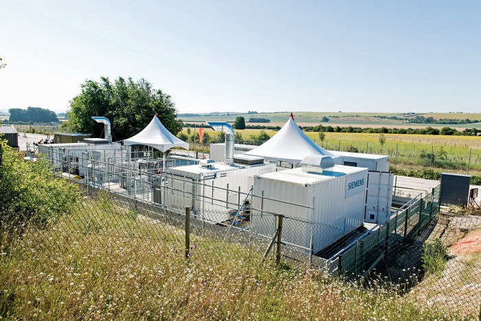

One more project. Sorry its in Norwegian but you all know how to get it translated I guess (chatgpt)
