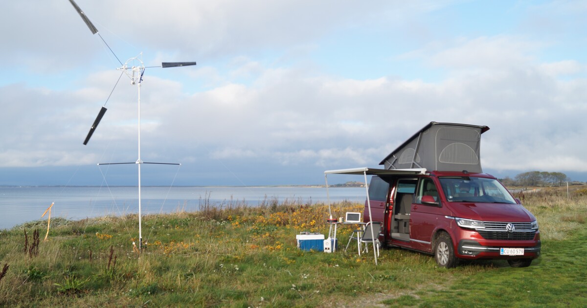

Nice to see coverage of anything wind, but it seems kind of silly to hear them say they “replaced the tower with 3 wires” while showing it on a tower. It really just has a short guyed tower, with guyed towers being standard for decades in the “small-wind” turbine category. Nothing new except it is the shortest, wimpiest guyed tower yet. Belt-drive is another typical beginner no-no. There are features I really like about this effort, and hats off to anyone who gets any machine actually working at all, seriously, cuz it isn’t easy, but, to an experienced small-wind person, this looks like it could be mostly just a lot of typical beginner mistakes - too short of a tower is a biggie. Most small turbines use 4 guy wires to make it easier to tilt up and down for the inevitable repairs. Looks like it is good for fun, until it gets hit with a strong wind, at which point, bye-bye. Here at our California location, we’re powered by the market-leading brand “small-wind” turbine, about twice the diameter of this one. It weighs over half a ton, is on a 120-foot tower, makes 10 kW+, costs at least $75,000 installed, and we’re on our third (3rd) one because even this market-leading-high-dollar unit can’t handle truly strong winds without destroying itself. There are broken-down units, some missing blades that each weigh over 50 lbs., and can fly over 800 feet in a storm, all over town. And it goes downhill from there. I think the advantage of this one is it could possibly be quickly taken down if winds get too strong, but then again, by the time you realize the wind is getting too strong, you really don’t want to be anywhere near a small turbine when it explodes! Wind turbines are mainly categorized by their method of overspeed protection, so you are not put into that high-wind emergency situation. Not sure what the method of overspeed protection, if any, this unit has, but good to see any unit that actually works at all emerge. Many self-declared wannabe wind energy innovators never get anything working, period! This at least works. Stick to it and maybe it will go somewhere.

Then in the face of that, you have people coming along making all the beginner mistakes with turbines that any experienced wind person can see would not survive even one minute in a truly strong wind, acting like they are saving the planet too. The whole thing is nuts. I have to say though, the turbines I build survive better and longer than most.
