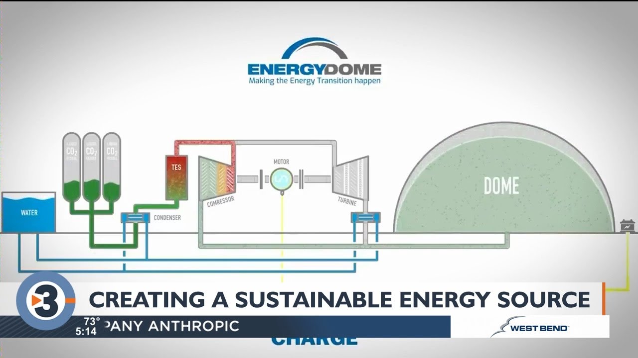

  • Closed thermodynamic transformation
  • Manipulation of CO2 between its gaseous and liquid phase
  • CO2 warms up, evaporates, and expands, turning a turbine to generate electricity
  • Energy storage sweet spot between 8/24 hours
  • Zero CO2 emissions into the atmosphere during the entire process
  • No cryogenic temperatures and high costs that are typically associated with compressed air energy storage
  • Massive reduction of costs by storing the CO2 at ambient temperature in its liquid phase
  • Patented technology that uses only water, steel, and CO2
  • All components are readily available worldwide from multiple Tier 1 suppliers
“Energy Dome’s technology uses a thermodynamic cycle, charging by drawing carbon dioxide from a ‘Dome’ gasholder, storing it under pressure, and then dispatching it by evaporating and expanding the gas through a turbine back into the gasholder.”

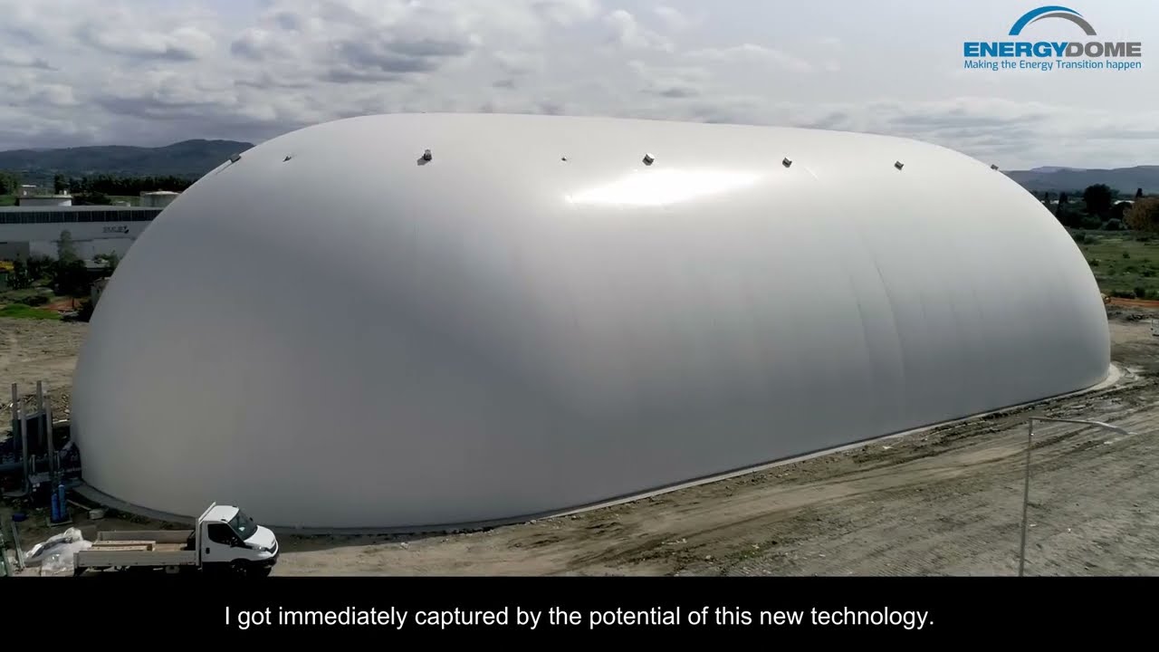

That gigantic dome to contain the CO2 when it is “spent” at atmospheric pressure can not be cheap to make.
CO2 expands over 500 times in volume from liquid to gas at atmospheric pressure. So the dome has to be over 500 times larger than the tank farms for the liquid CO2.
The benefit of liquified air is that you don’t have to contain it when it is converted into gas. Just release it back into the atmosphere. And you can get pretty good round trip efficiency from liquified air to if you store and use the heat energy from the compression.
8 posts were merged into an existing topic: Slow Chat II
OTOH, that seems to be about the only custom part, and from the quote below, from the company: But this is a low-cost component, requiring little more than a strong but flexible PVC-coated textile, which is already manufactured for use in biogas plants.
