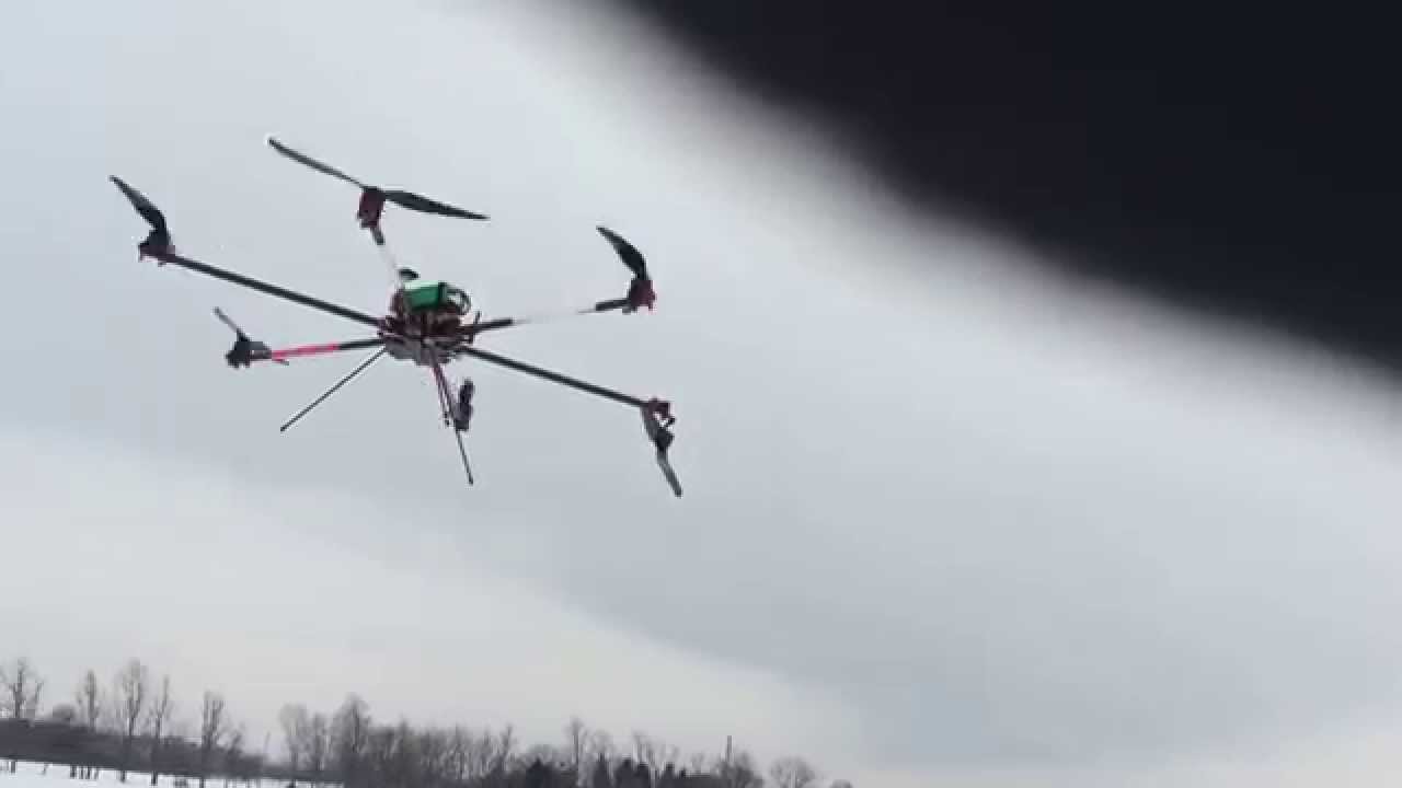

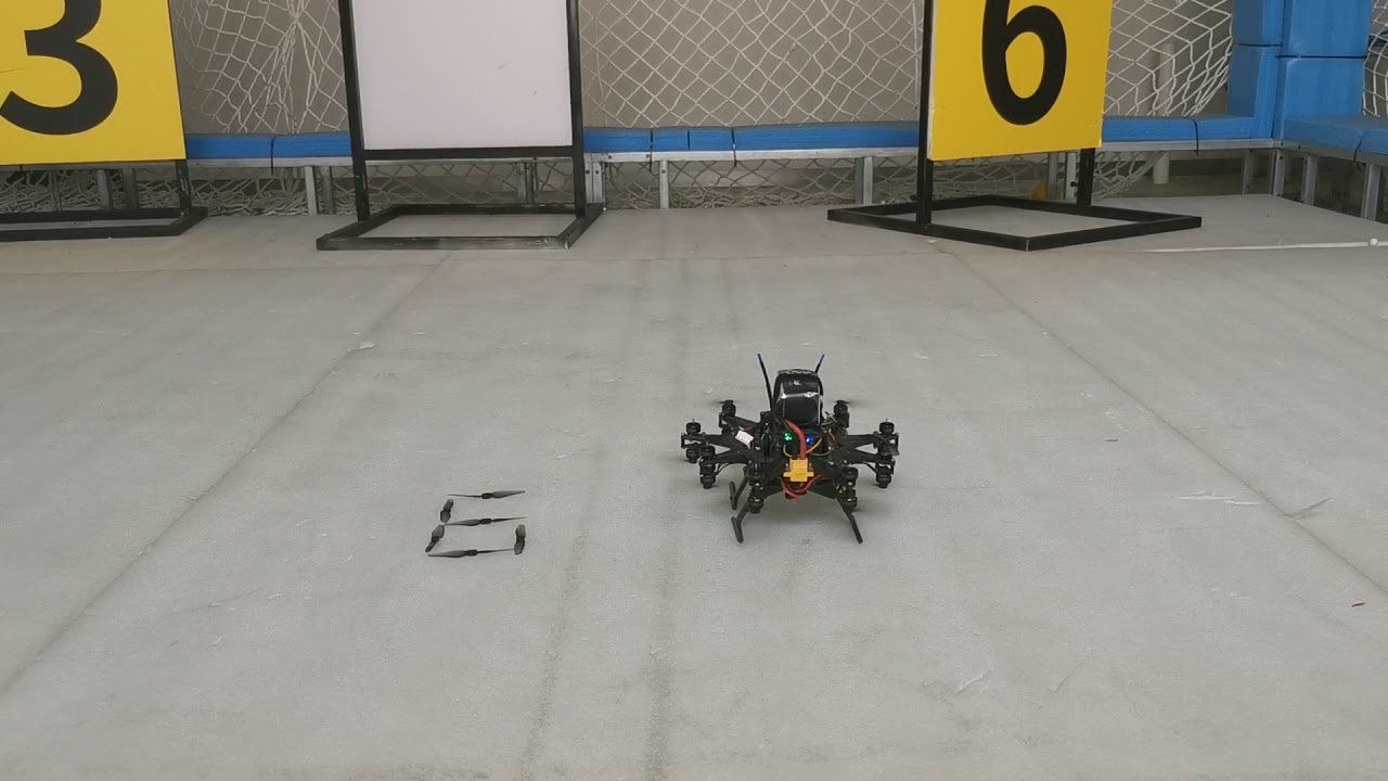

There is many multicopter drone prototypes that have redundancy in motors and propellers so multiple of them can fail and the drone will keep flying. I would say a multicopter with redundant motors and propellers is even safer than fixed wing aircraft or helicopters because the multicopter can keep flying like normal on the redundant motors and propellers to a normal landing, while a fixed wing plane or helicopter has to immediately find a suitable spot for a emergency landing within reach of gliding or autorotating.

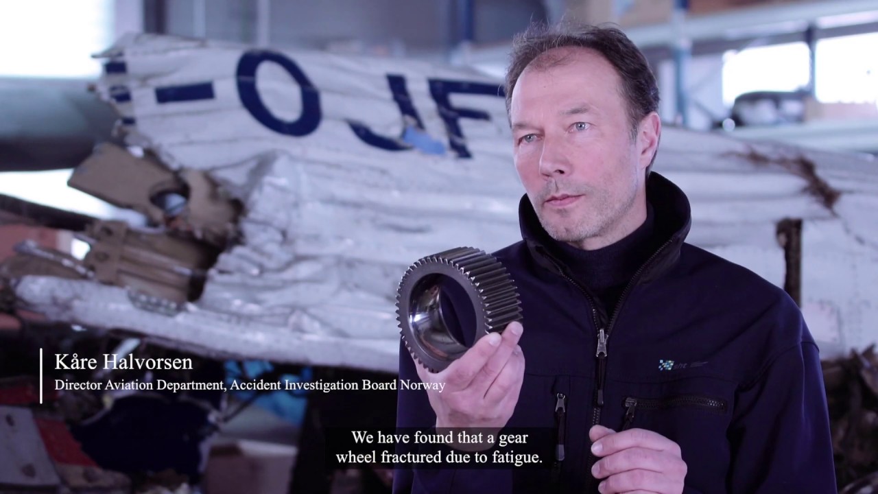

Plus a electric motor us pretty unlikely to fail. Compare that to the gearbox and bearings on a helicopter where a single point failure is catastrophic and unrecoverable, like we have seen on some accidents where the rotor has left the rest of the helicopter after gearbox failures of just one planet gear.
The battery pack on a multirotor can be divided into redundant units as well.

Redundancy keeps the worlds most dangerous and critical industry’s running. Like nuclear powerplants, etc. And it is trivial to implement on multirotor drones.
On helicopters on the other hand single point failures can lead to catastrophic unrecoverable situations. Like fatigue cracks in a gear causing the gearbox to explode and the main rotor dethatching:
