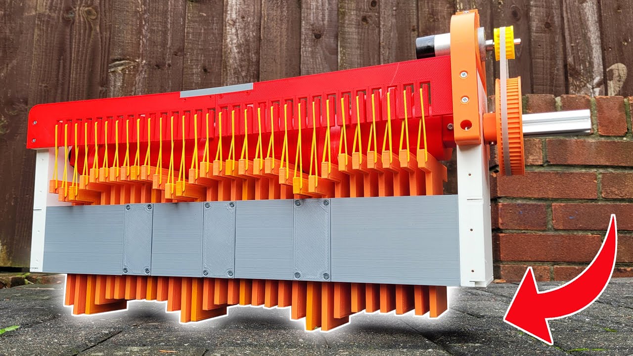

And interesting solution for wave drives.
Also looking like it could be a multi piston generator?
Is it really interesting though if it doesnt work? I think you could have known without building that it would not work. So to me this is mostly just playing around to make a video for the sake of making the video.
As it didnt work for propulsion I doubt it would work for wave power. But for waves it would probably work relatively better. But the mechanism has a lot of friction and is extremely bulky.
my 5 cents

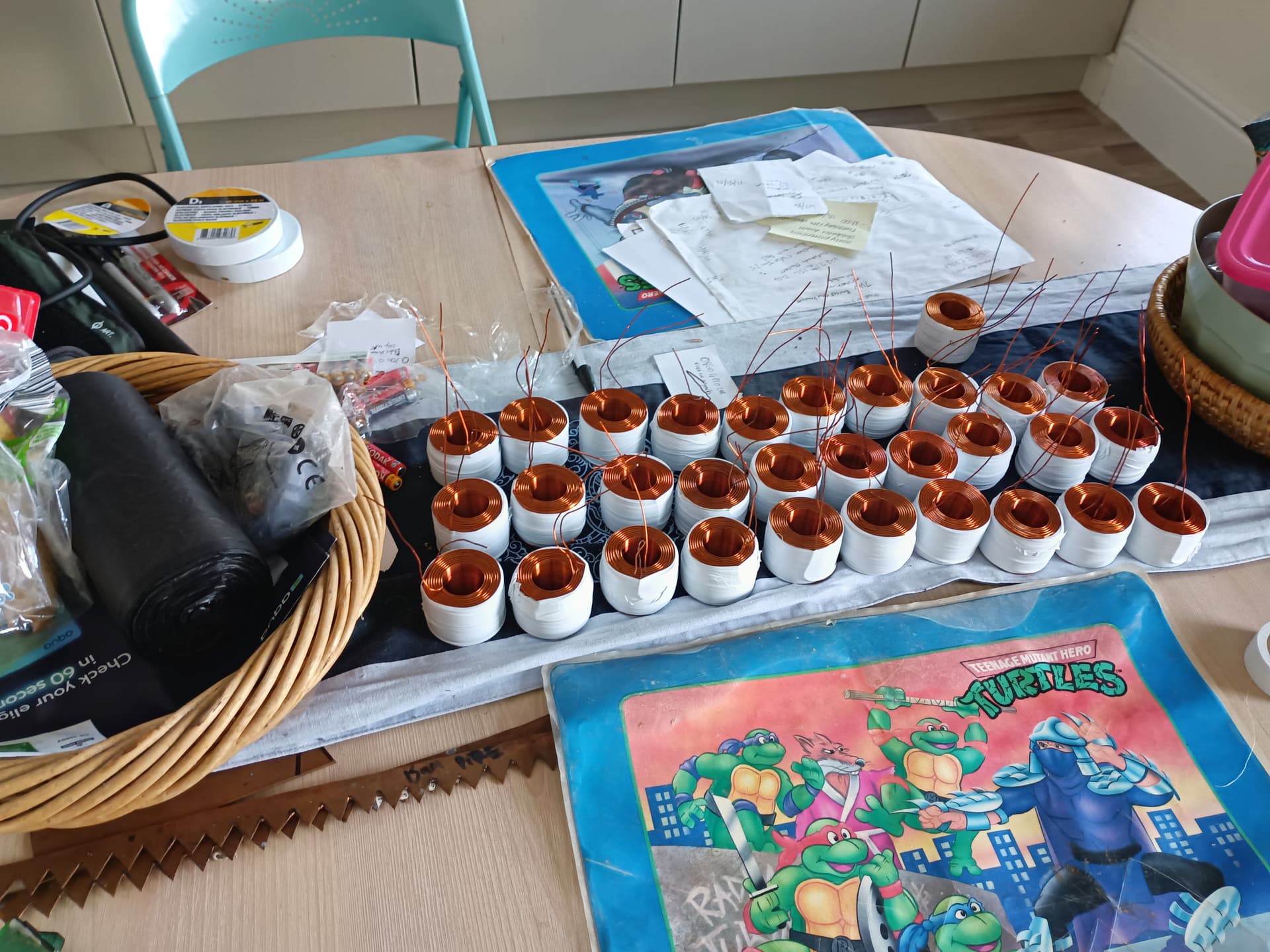

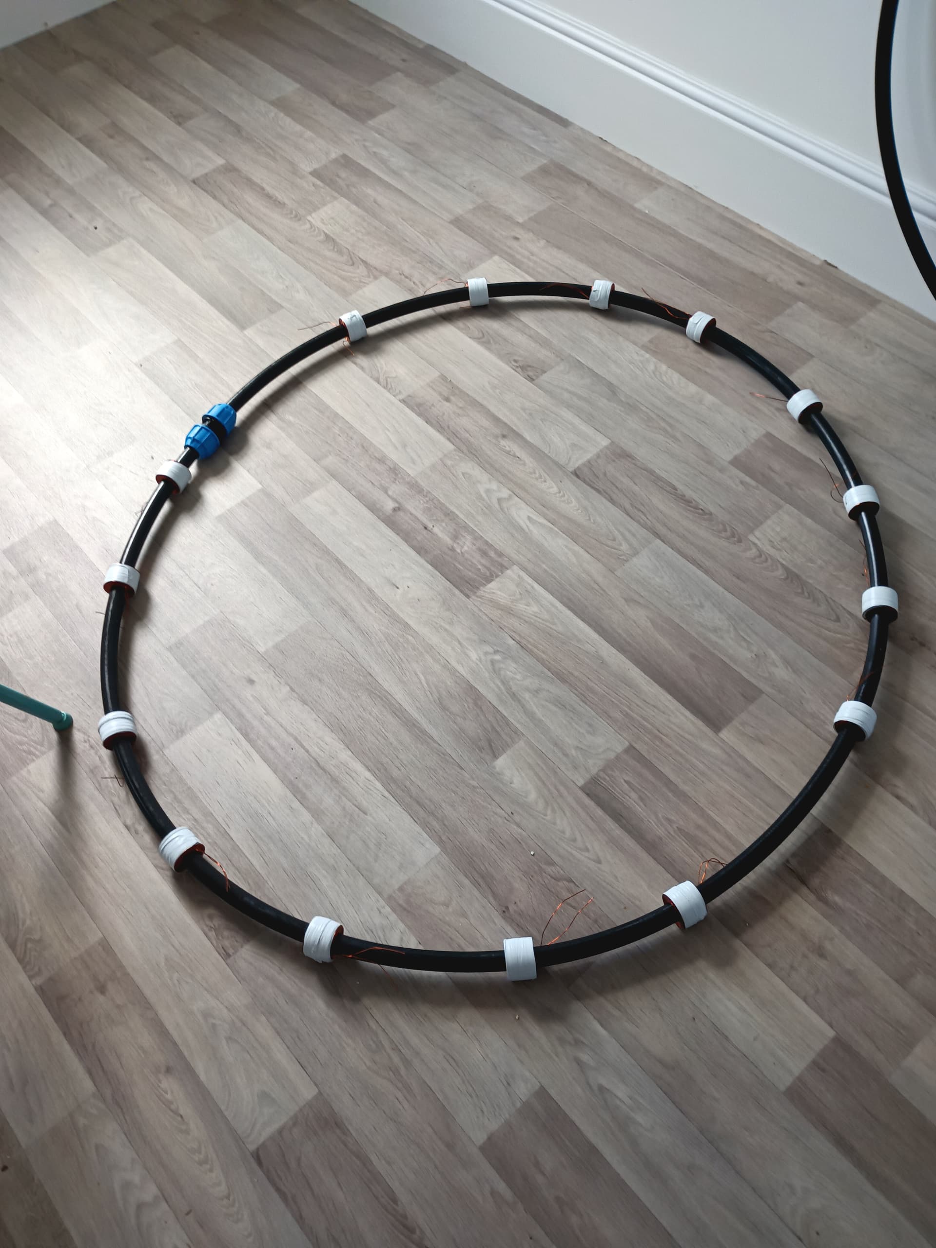

I know it’s been awhile, I have something to show you if you don’t mind? I’ve been working on one of my old ideas. Sunk about £1000 into it so far because coils and magnets make up most the costs. It a 4ft wide gravitational potential generator. That perhaps could bolt into any rotary rig? Be that air gen or ground gen? In the process of building the second one. Loads more work to do. Making sure the coils are equidistant is just but one challenge. Soldering is another but could alway farm out the work where I may not be able? So far there is 15 coils per unit so 30 coils in total. 20 n42 neodymium spherical magnets in each unit making 40 Magnets in total. The idea could be used in a nested configurations or stacked like a kite train? It might also do well from central supports? As with all those coils on the tubing it tends to go into an oval. Which I think might be counter productive? So I’d like to throw this out there for feedback and if anyone is willing a collaboration? as I know it might just bolt in to some of the rigs I’ve seen on here? For a few lucky one I might just post it to you if you would like to have a play with it? I’ve got it this far with alot of choice words and cursing. The coils were especially tight to fit manually. Have had a lot of fun doing it so far from my kitchen! Any help or assistance is welcome. I hope you all like what you see so far after my time away? Just thought I’d share, as you never know where it all might leads to?
Not sure how you are proposing to move the rotor through the coils
Also Annular Electromagnetic Generator for Harvesting Ocean Wave Energy or for some other things including AWES. It looks like a tire tube.
Thank you Pierre b. That was an interesting read for the annual electromagnetic generator. I was mainly concentrating on it use in a awes applications. But wave applications was good head up moment for me. I don’t think what I have built so far is anything close to a tyre tube as I’m using HDPE pipe as the main body of the rotor.
The coils are about 600 turns of 0.8mm wire with dimensions of 35mm*50mm with a internal I.d. of 25mm. Total rotor dia. is 4ft. So should be able to get something out of it at that scale from what I read? I wonder if number of coils will have an impact on performance? Considering I have 15 coils per rotor. With 20 sliding 19mm spherical magnets in the tube. The magnets could be arranged in a variety of ways? To produce various effects with the magnetic fields to generate electricity. Sound like I was on the right path with my thinking. I just didn’t have the numbers to show it. So thank again for showing me the way.
