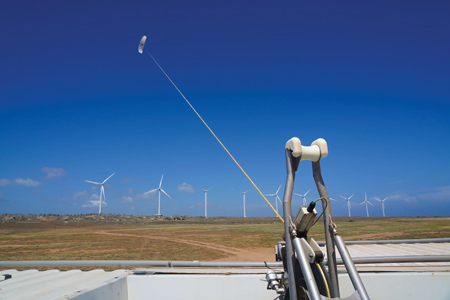

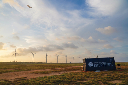

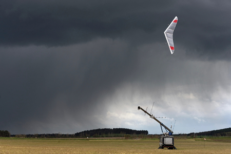

A control system steers the kite or glider so that it flies stably on a cross-wind trajectory, which results in a high pulling force on the tether. The tether is connected to a base station on the ground or to a fixed or floating platform in the case of offshore applications. There are three main AWE concepts:****
Ground-gen: A tether is wound around a winch connected to a generator located in a containerised ground station. There are two phases in a cycle. Electric power is generated in the traction phase, in which the kite flies out in figures of eight or circles, pulling the tether which is reeled out, turning the winch and with the electric machine acting as a generator producing electricity. In the retraction phase the electric machine is used as a motor to reel in the kite before it flies out again, starting the next cycle. The energy used for the retraction is less than 20% of the energy generated in the traction phase.
