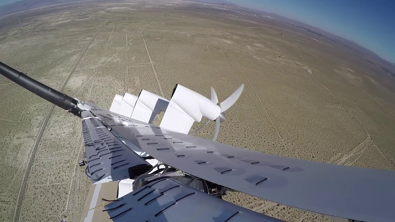

About 14’ after the beginning we can see the whole loop and hear the sound variations that occur periodically on Makani’s video during each loop:
Then during figure-eight we can also hear athe sound variations:
