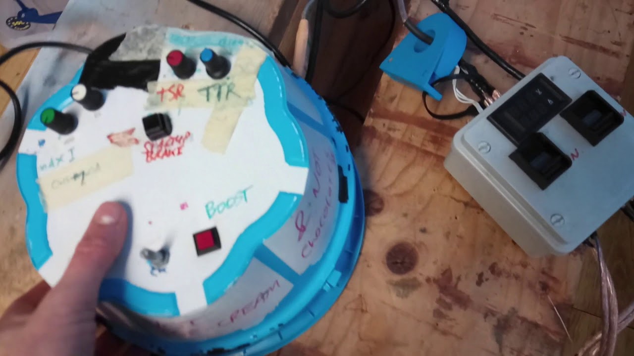

Looks like a birthday cake to me.
Some people… Douglas Sprigs Selsam
There’s a warning on the box
It clearly says
ā€œNot Ice-cream and Not Chocolatesā€
Cake
They just keep making better idiots
:wink:
Fair enough the controller is housed in a recycled chocolate box
My previous controller box had been an ice-cream tub… You’re probably right.
Next up should be something more robust and moisture resistant like a cake box.

Forgot about our beautiful accent. Was interesting to learn more about your ā€œgrind staionā€ :stuck_out_tongue:
The way you connected the load cell seems a bit hackey (unlike to rest of the station). Lots of friciton on the rope and stuff.
I have to admit the look of the white/blue box somewhat reminding of a cake, before @dougselsamā€˜s comment. But I had the politeness to shut up :slight_smile:
The way I connected the load cells looks dodgy at best
It wasn’t all that bad. The batteries were standard bike 36V housings with their own switching and onboard BMS so not too much to go wrong. The junction box with 2 hefty enough switches just allowed connecting and disconnecting them in parallel to swap out full ones. There was also a Voltage and current meter to keep me aware of the battery states.

Where are you seeing lots of friction on rope?
Are you implying the Aero drag? The shaft is a very small diameter as compared to the rotors.
The ability to work a smaller diameter shaft at ground level helps to keep the ground station small.

I just meant the rope connecting the load cell. Might not be relevant.
OMG I’m dense.
Yeah ok I know what a load cell is everyone okay!
That rope was a fairly good easy way to get the tension load cell in kinda the right alignment .
