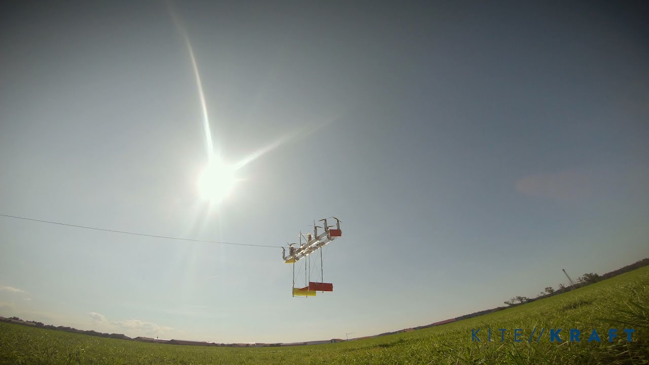

I congratulate Kitekraft on a very impressive flight.
What I would like to see next is maybe flights in real winds. Flying as a drone in low winds is quite different to flying in high winds. We can see that there is little tether force as the kite is rolling a lot when flying the lemniscate. This means that centrifugal and gravity forces are dominating tether tension force.
Thank you!
We’ll give a few details in upcoming blog posts or on the upcoming the Airborne Wind Energy Conference. What I can say already,is that the dominating force clearly is the lift of the kite’s boxplane main wings. – Stay tuned.
