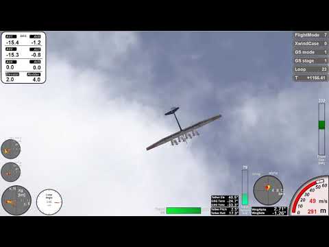

The wind always seems to be too low. Is it so difficult to test with 5 or 6 m/s wind speed in order to know the real average net-positive power?
This reminds me a bit of the Makani technical videos. In one of them we can see that even with a wind speed of 10 m/s, the average power still seems negative:
