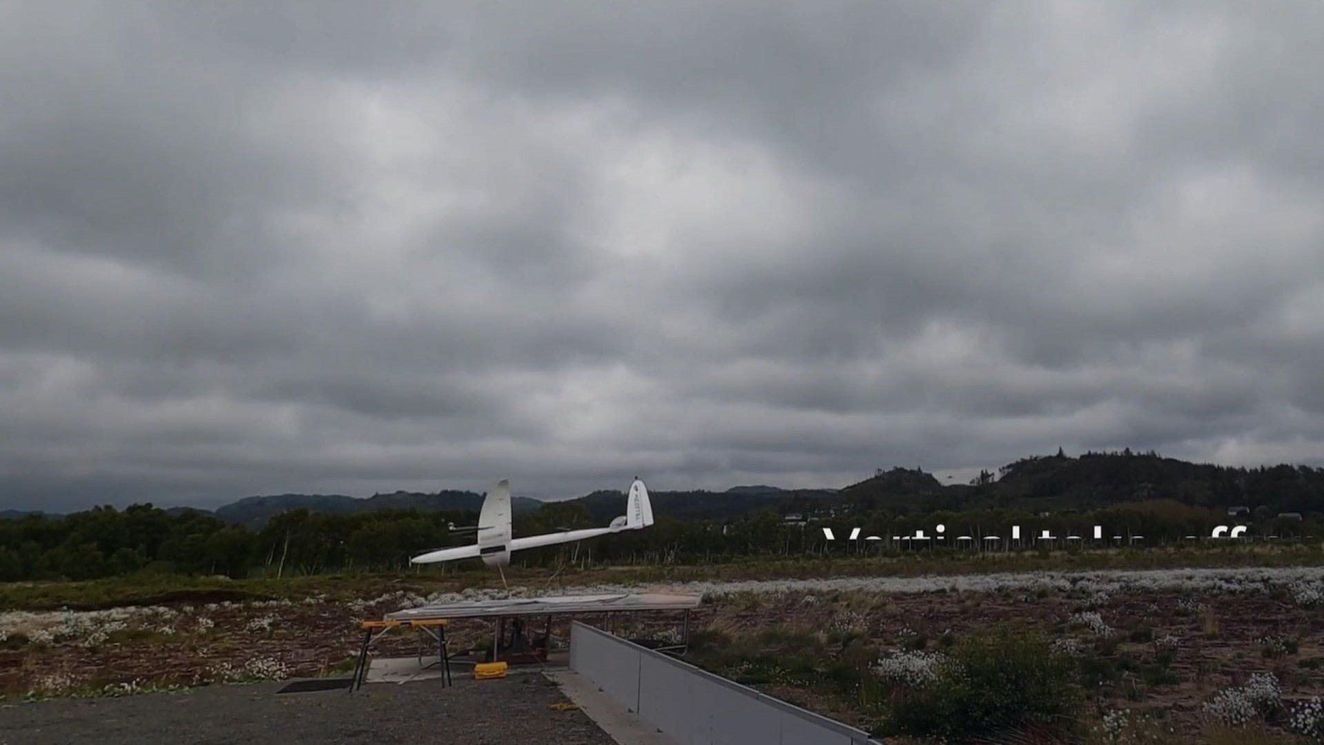

The KM1 Spark kite automatic launch and landing
A strong focus of engineering of a more robust kite system pays off with great results in our August 2020 test campaings.

VTOL in high winds is harder than it seems on paper. But we have made huge progress… main challenges seem to be the interaction of the VTOL system, tether and the main wing. The tether force must be small but should not go slack. Also one needs to consider each propeller as if it was a helicopter, ie. angle of attack and forward apparent windspeed can not be dismissed. Anyways our system is not yet perfected, but we are using VTOL on a regular basis now in low and high winds. Having VTOL accellerates testing because tow launch is very dependent on wind direction and the space available for launching, which has to be open and free of obstructions, in the direction of the wind.

The team have been working hard and conditions were good for logging power production curves on our biggest kite. 3 flights was done the same day. We peaked 16kw in 4-9m/s wind and in the last flight we flew production cycles for 29 minutes.

I believe the wingspan is just above 7 meter and wing area is 3 sqm. We are aiming for 20 kW average. But in what wind conditions etc, … the details have not been released to the public yet. Same with the weight. One could assume that the design is not optimised at this stage for low weight. We have not released a power curve data yet, I am not at liberty to suddenly share this information as you might understand.
