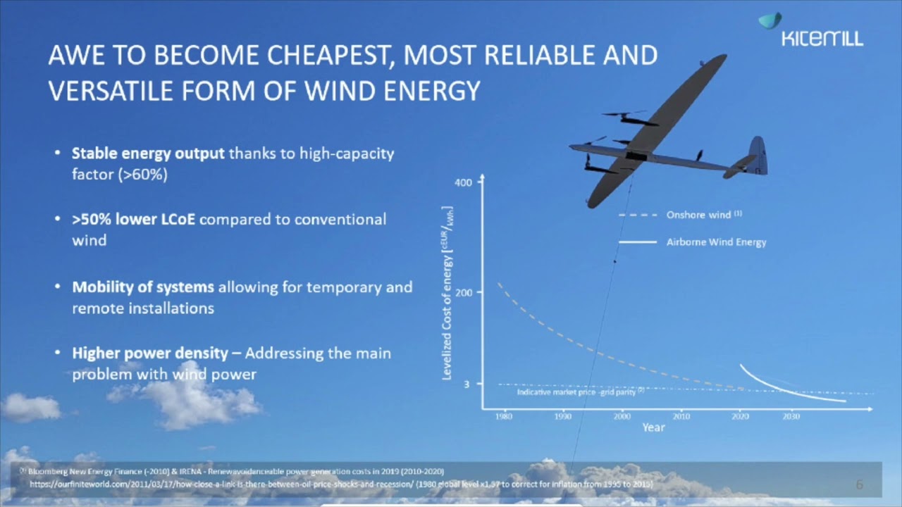

Nice pitch from Thomas at all energy
Sounds really good. Seems like their advantage is simple takeoff and landing.
I’m not quite understanding how a 40 m wingspan is going to make 3 MW, if a 7.5 m is only making 20 KW though.
I’d say maybe more like 569 kW?
This is correctly observed. The KM1 was designed now more than four years ago. Although we have made incremental improvements, these are mainly related to robustness. Also the software is far from complete in terms of producing full power. The efficiency (power per wing area) should improve with better kite aero design and more refined software. A new kite design is just around the corner with KM2, though depending on the funding situation
Though 3 MW is a hard target for sure, and we did not yet produce 20 kW with KM1 on average. The goal of our flights are currently focused on flight endurance and low/high wind handling, not power output. So expect a lot of low hanging fruit to be sorted out once we are flying for longer durations

Hi Tallak: 3 MW sounds like what people often call a “stretch goal”. If a 7.5 m unit ends up in the 10 kW range, that might imply ~300 kW for a 40 m wing, which would be one-tenth of the stated goal. Well, that is still a lot of power. For kite-reeling, it looks like a good approach.
I could not really go into detail about the realism of these numbers. As you may expect there are some different opinions about how far we will get in the team, but the truth is none of us know for sure. So in a way any number is as good as the other. But the overall picture is the same whichever numbers you should choose.
300 kW for a 40 m wing, and perhaps 3 MW for the same wing with a suitable fairing of the tether which cancels out almost all of the tether drag.
