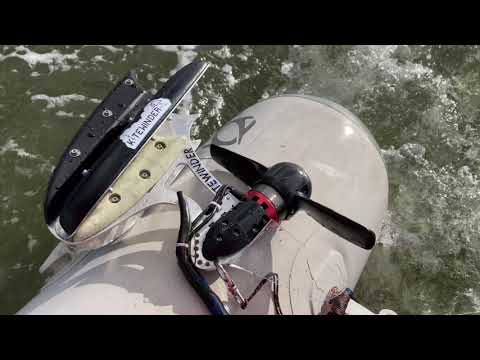

meanwhile, our hydrogenerator is maturing well. All stainless steel ! have a look
Love it
One question
On the underside, there’s a second vertical fin behind the main keel board… Is it a like a safe torque coupler just in case you hit something?
hello @Rodread , it is a dynamic fin that is linked to the motor to counteract the torque of the propeller. the motor is mounted on a inner shaft. when there is torque, it position itself pasively and force against the propeller torque, when there is not, it simply stay in the axis
Text of the video:
A short footage of our hydrogenerator Seawing for sailing. We perform test from 4 knots up to 12 knots to test the stability of our design and also record first power production. During that test, we reach 100 Watts at 5 knots and hit a maximum of 170 Watts around 7 knots.
That looks to be efficient.
At 1:12: “Le premier hydrogénérateur tracté, nageant à la traîne de votre voilier”.
Translation: “The first towed hydrogenerator, swimming behind your sailboat”.
This is actually what we see in the video.
An AWE version in the future, hydrogenerator + kitesurf?
Nice idea Pierre, I would add hydrogenerator + kitesurf + daggerboard/foil to go crosswind
The new version now has two propellers Seawing, hydrogénérateur pour la plaisance – Kitewinder
