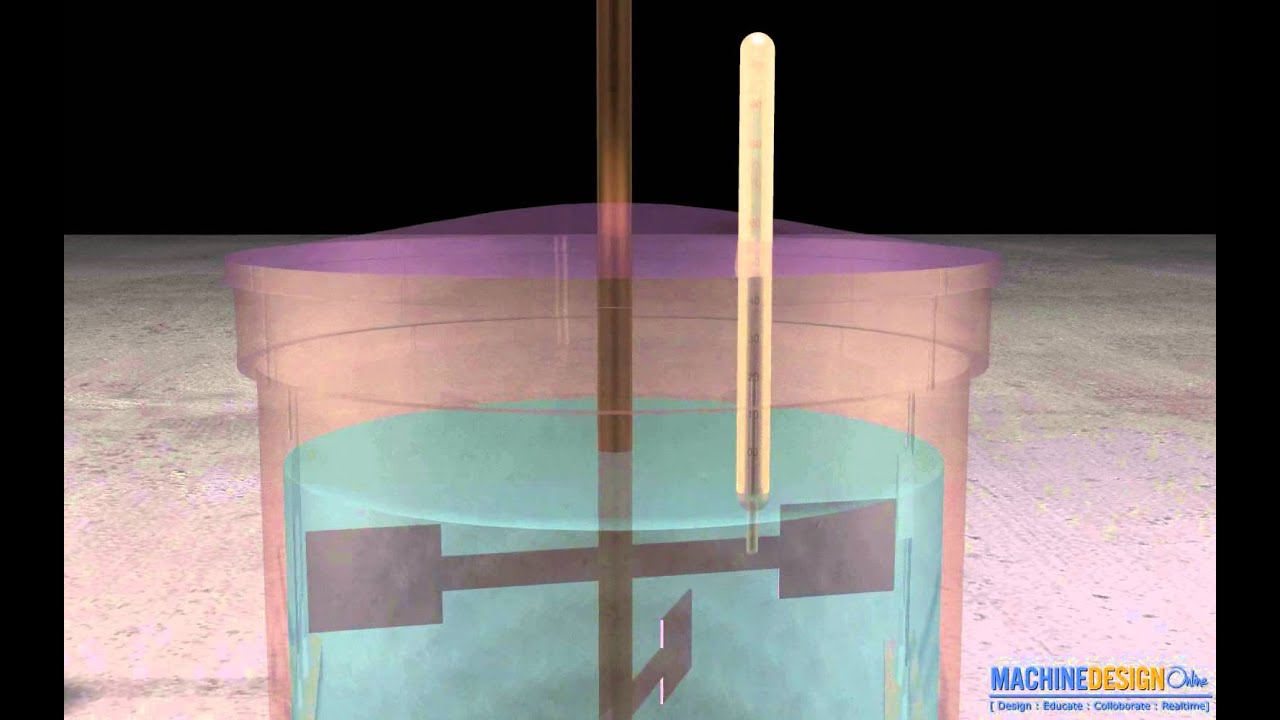

Making and using a ground-based water brake AWES. The winch converts rotational energy into heat without the involvement of electricity, so off-grid, by using a water brake as a Joule machine replacing the ground-based generator. The storage is also assured with (hot) water. An AWES could heat one or several houses.
If a yo-yo AWES is used the intermittent use (reel-in and reel-out phases) is less problematic than with a generator, thanks to permanent heat storage. Only a motor or a spring is used to wind the tether.
Other ground-based AWES comprising rotary devices could also be used, such like Daisy or SuperTurbine ā„¢.

The Water Brake Windmill
Heat generating windmills convert rotational energy directly into heat by generating friction in water, using a so-called ā€œwater brakeā€ or ā€œJoule Machineā€. A heat generator based on this principle is basically a wind-powered mixer or impeller installed into an insulated tank filled with water. Due to friction among molecules of the water, mechanical energy is converted into heat energy. The heated water can be pumped into a building for heating or washing, and the same concept could be applied to industrial processes in a factory that require relatively low temperatures.
Drawing of heat generating windmill
