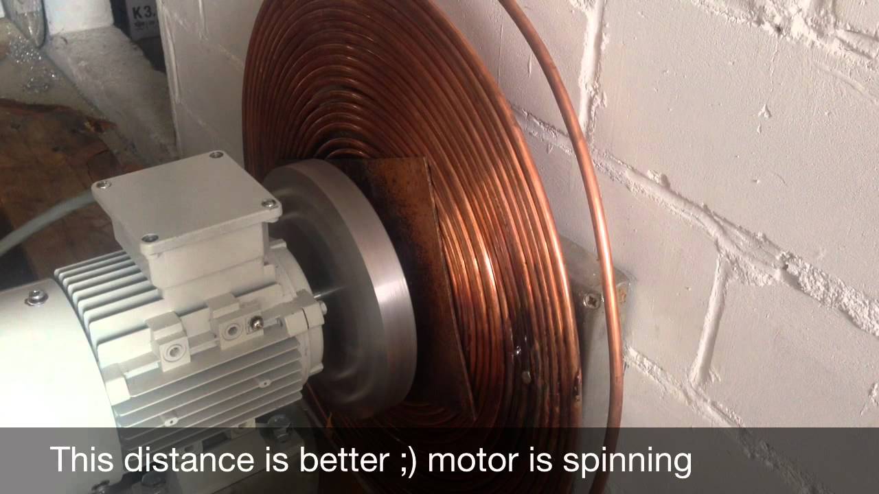

I was thinking about every stationary machine that nowadays uses a motor. The applications for that are endless. Install the driveshaft somewhere convenient and attach the machine you need to power now to it.
Like this for example:
I don’t like that water has such a low max temperature, you need to have a larger surface area to give off the heat and if you use it for cooking, the temperature difference with the cooking water is absent. Oil might be better despite its lower heat capacity, in some cases.
