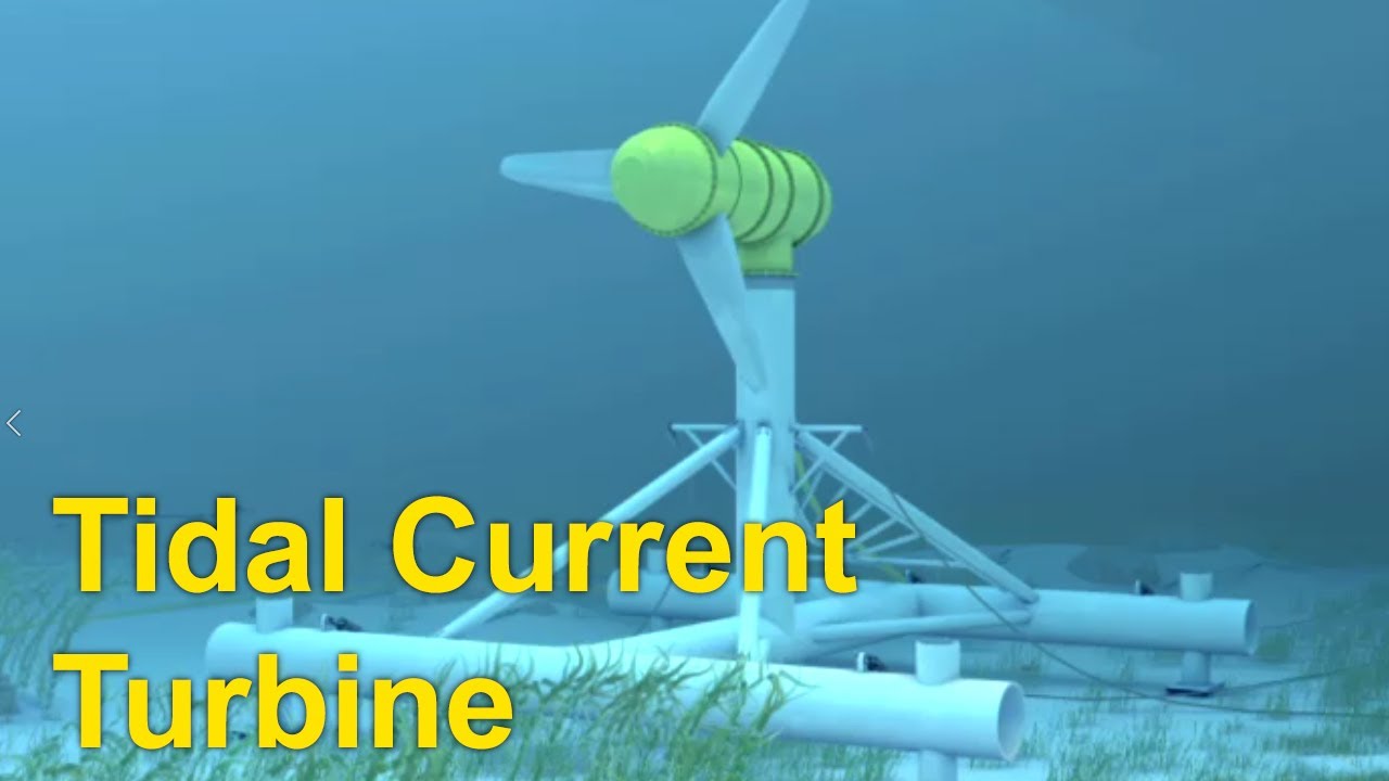

Crosswind kites seem to struggle being truly viable, both in the air and underwater. The drawbacks can be a lack of reliability, material wear due to irregular and high forces… as for their AWE cousins.
The fixed turbine (as for a conventional HAWT, as also for some AWES, E.g. Kiwee) seems to work:
nice renderings…
