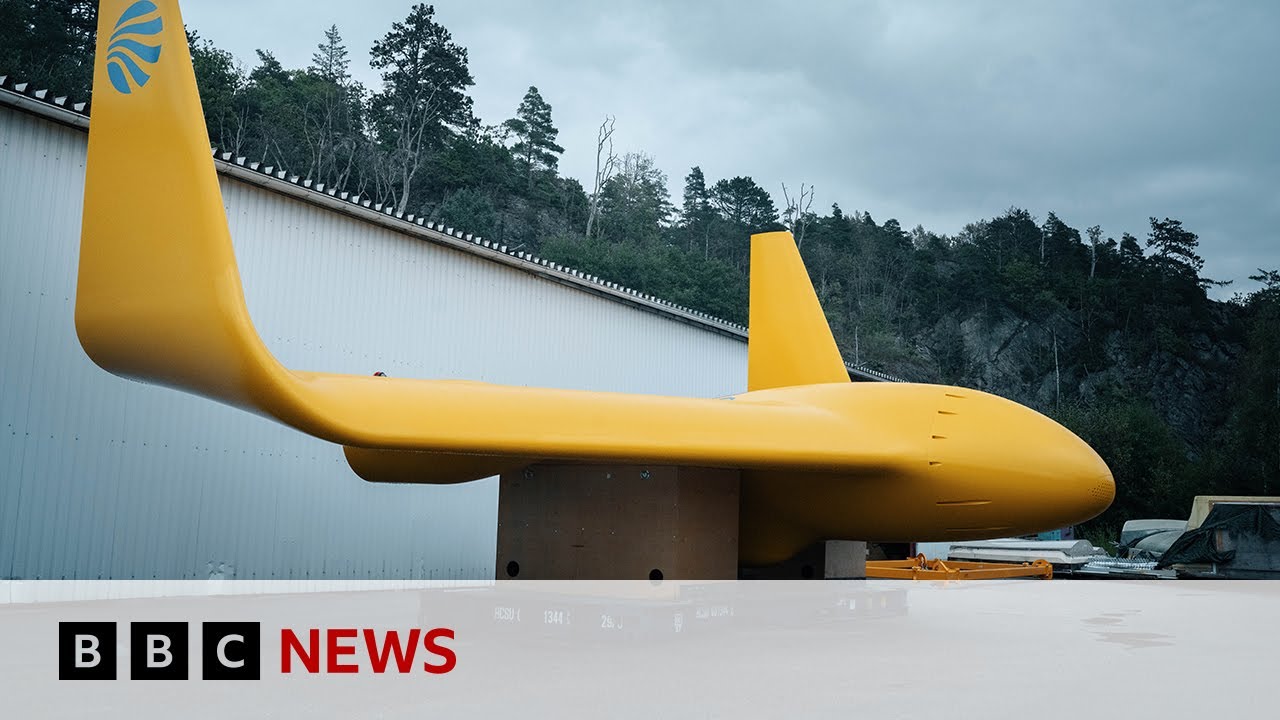

Big tether fairings
I have been wondering about tether drag for Minesto because the physics involved for subsea tethers is more demanding than for flying devices (forcing a very short tether). It is interesting to note they installed the fairing.
Also interesting to see they installed real 3D fairings rather than tustles. I would think the latter would be much easier to maintain and handle…
Did you mean tussles? I’m not following anyway.
Hi. I am actually not sure what the term is. I was referring to those thin strips of leather that could hang on the back of a country style leather jacket.
I have seen those being used to reduce drag on seismic streamers, a use case nearly identical to Minesto’s I suppose.
The device I am referring to is a simple one made of thick tarp, sewn as a tube into which the streamer is inserted, then having triangular tarp patches hanging after the streamer.
The device is cheap and easy to handle, eg. it could be put on a reel. A solid fairing I suppose could not do that.
I think its easy to make the design for subsea components too fine and detailed. Things grow subsea, parts need to be coarse and solid. For instance, I expect a solid fairing may grow stuck quite quickly. But these are just guessing and speculation. Time will show if Minesto’s fairings do the job or not.
At 0:35 on the video, we see the modular fairing.
I thought those were called tassels, but google says it is either that or “fringe”. Towing streamers with them:
Note the thin cables, you could wonder if that still works with thicker cables.
For under water flygen I like Minesto’s solution better:
  • Likely much better hydrodynamic performance.
  • Less likely to catch seaweed or to foul due to the smoother surface and the likely anti-fouling coating, and with that have a likely similar cleaning schedule as the kite. Cleaning a coated surface should also be easier and quicker than cleaning that much fabric all at once. Their business plan calls for servicing every 6 months, but it had been operating without problems for 4 months at the time of this talk so I think the speaker is implying longer time between servicing might become possible.
  • Likely modular, so likely easier to make, to replace or to clean individual parts. The airfoils are never in focus in de video, but you do see dark spots at the chord line, which might indicate bolt locations to bolt the two halves together around the cable. You can imagine during servicing that makes it still possible to check the cable itself.
The airfoils do have sharp edges. If they are not aligned during operation that might be a place for seaweed to collect.

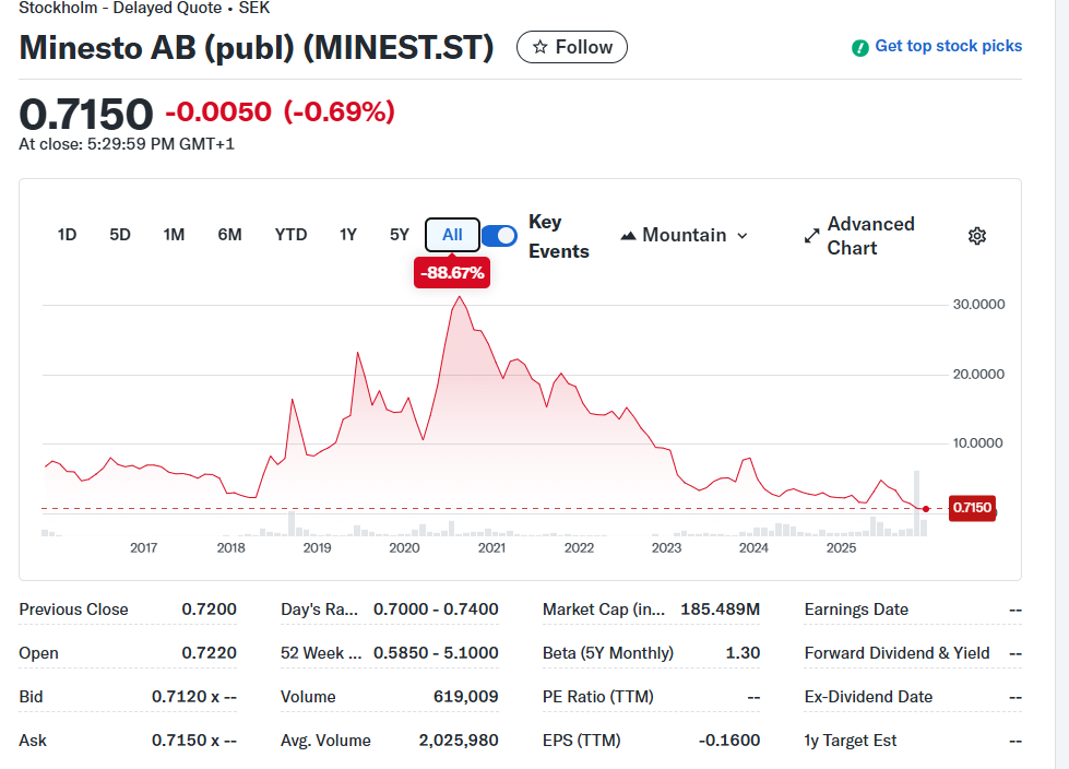

Hi Guys! See Minesto’s stock price, above, now down to the equivalent of just 7.7 cents per share. Jump in and buy if you still think it’s going to succeed! :slight_smile:

I just checked their stock price, and if you had invested at the peak price of 30 Swedich Kroner per share, you would have lost something like 98% of your money, because their stock price is now down to 0.715 SEK, which is about 7.7 cents.
Now a price this low could be a great buying opportunity: One could quickly double one’s money just by “noise” in the price based on some lingering bit of positive-sounding “news”, or just other people bidding up the price for no reason other than the low price itself.
