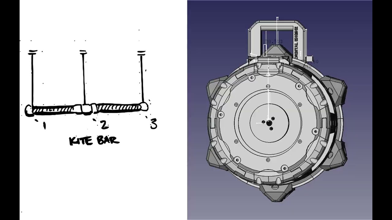

OKE Precision Winch "Reel and Rotate" Technology
The OKE precision winch functions similar to a spinning reel. You can power it either with a motor or manually via a crank. It controls three lines independently.
Moreover, the winch has a feature to synchronize the Orbital line reel (left line), the De-power reel (depower line), and the baler. This allows these reels to be locked together while still maintaining their ability to rotate.
This configuration allows the kite or any other load to move freely. Additionally, because the Orbital and Depower lines rotate around the tether line (right line), it helps in compensating for any twists in the system.
