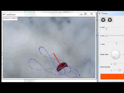

Now to pair this with visual sensing, we would train a neural network to predict the possibility of which pixel the kite will show up on next. A foil will behave in a similar way given the load and tension on the lines. If the tension is X, you can assume the amount of lift the kite produces. If the kite is moving across the pixels at a certain rate, (given the length of the lines stays constant) you can determine the speed and lift of the kite.

As for the camera being expensive. The kite engine is mounted on a turret that always faces the kite (passively), on which there are rails to attach a camera. Using a fisheye lense, and a constant length of line. Many things can be determined visually and even more combined with tension sensing.
Automated control would be very much like teaching a person to fly a kite, albeit through video.

"There is a function in openCV called “line” which will draw a line between two specified points. The angle of the line can then be found easily by trigonometry. "
Kyle Hounslow
YoloVx should find the kite for you, i believe. From there on its maybe not too challenging.

  • Seeing kite’s position with a camera is almost a non issue, the algorithms can be very simple since the kite is pretty much the only thing in camera’s FOV, it is not like it is hidden in a forest. But there can be some tricky situations like seagulls playing around or, more seriously, the sun shining right behind it. Also having it painted with a contrasting, asymmetric unique pattern would help with estimating its orientation if kite-attached electronics is such a dreadful perspective. During night, instead of trying to illuminate it with a flashlight or lase I would rather recommend a pair of LEDs one at each tip of the wing or at the two control line knots where the bridles fan out. That would allow the visual algorithm to estimate both orientation and distance to the kite. Fog I doubt to be an issue since when it happens the wind’s speed tends to be missing too.

  • sensor weight was an issue at small scale, but video processing speed/latency was as well. But we gain an order of magnitude on both in the last 10 years, so it will likely not be an issue in the next decade. We will probably have both for redundancy.
