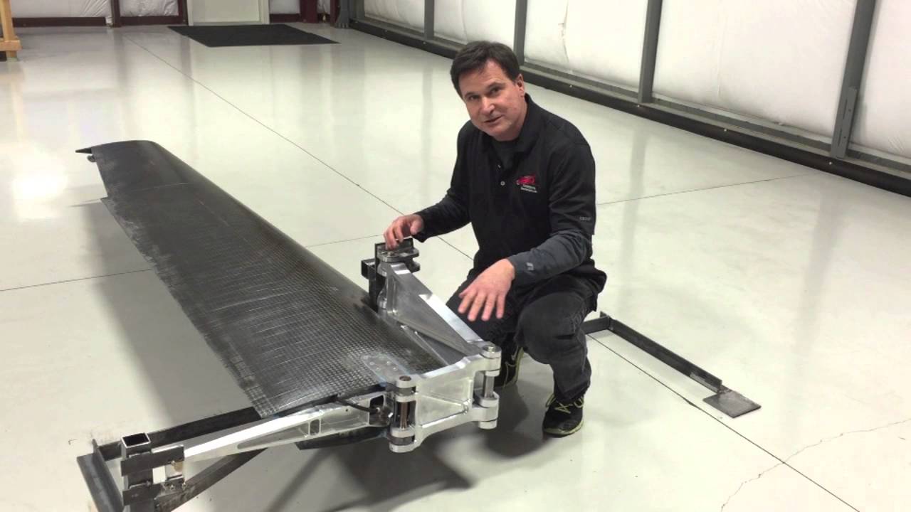

Various articulation methods have been trialled to prevent overspeed on “normal” wind turbines
However articulating in the plane of rotation about their root isn’t really an option as that’s how they deliver power.
To understand this have a look at a flying car wing
(I know)
Not going to work on a “normal” wind turbine
But where a blade doesn’t fix to it’s plane of rotation at the axis… Like on a ring rotor… Daisy Kite turbine
This sort of swing wing geometry blade fold away is legitimate.
The pivot can also be in the middle of the blade to bring both inner and outer tips to the ring.
