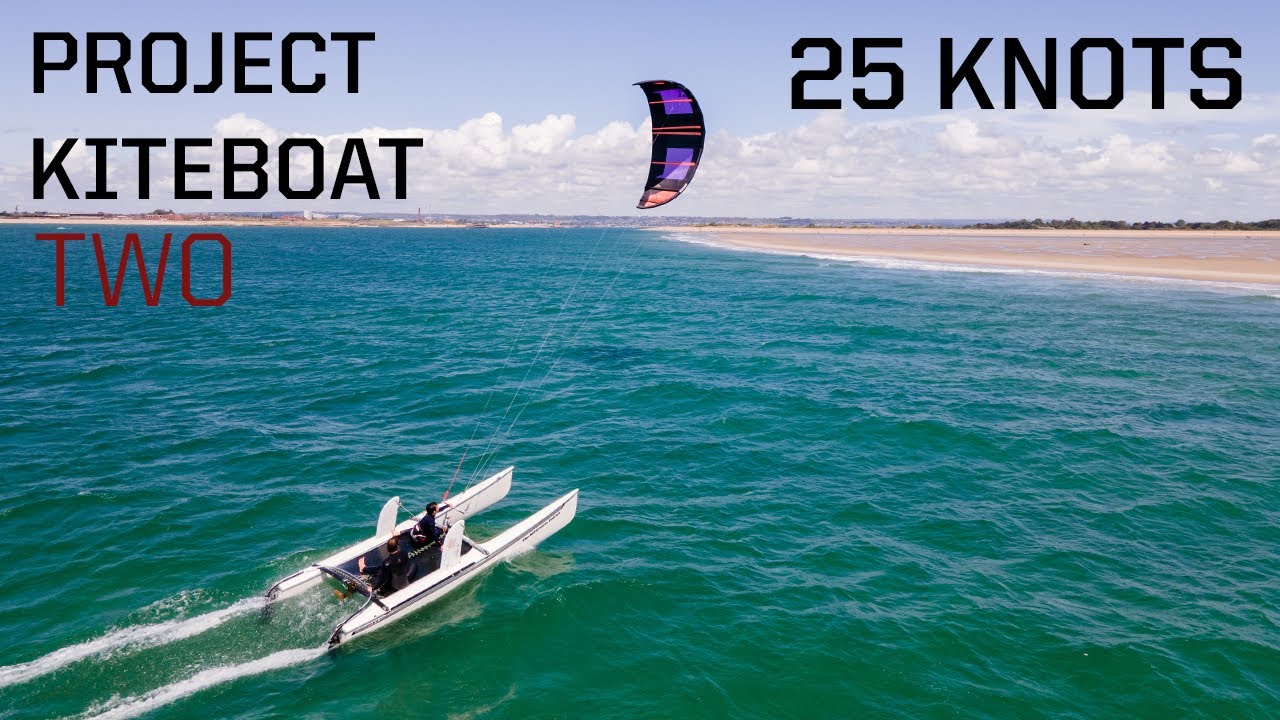

Here’s one analysis of actual kite boating

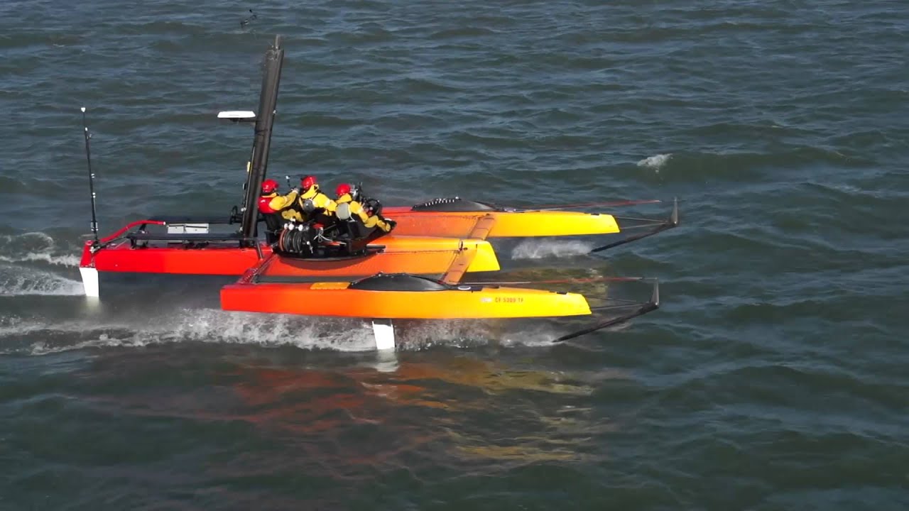

But a more extreme version was done by Don Montague 7 years ago

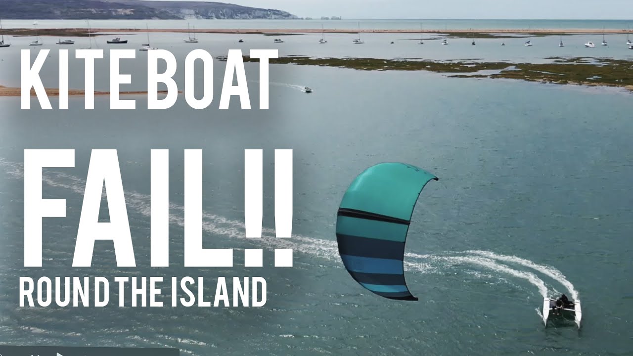

Interesting Roddy. Seems like there is no good reason we don’t see more kite-powered boats, at least for niche applications. Looks pretty fast. After watching these videos, youtube spoon-fed me this one of a couple of guys kite-sailing partway around the Isle of Wight - you probably know them?
Well looks they ran out of wind. Luckily a boat showed up willing to give them a tow. One more case of needing a tow back to shore once the fun and/or wind has expired. They sound Australian?
