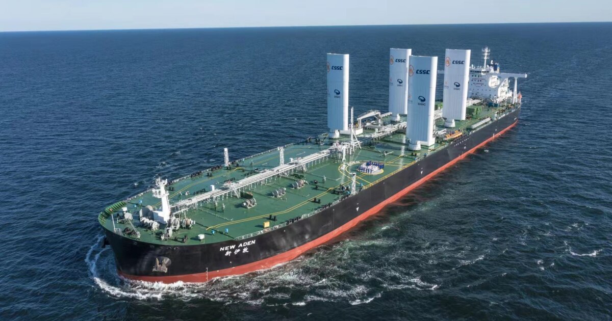

Here’s another one - an oil supertanker from China with 4 square-rigger sails:
Claims a 9.8% fuel savings.
Should we assume they doubled the real savings? Or don’t they really know yet? The fossil fuel industry trying to “decarbonize” always seems ironic. I think if it works well they should do it just for the sake of efficiency - to save fuel. Someone could be the biggest fan of fossil fuels and still be in favor of saving fuel use when possible. :slight_smile:
Ooops - “edit” here: It says “whose four large sails will cut down average fuel consumption by nearly 10%.”
OK so that is just projected fuel savings. Remember, with this stuff, all news must remain perpetually “in the future”…

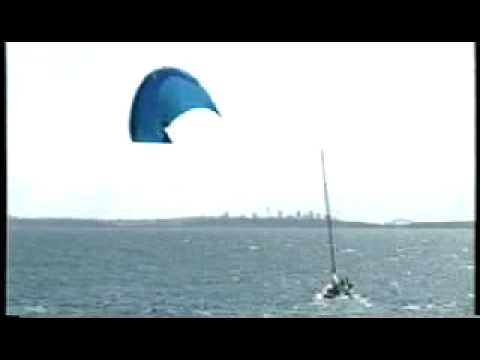

Peter Lynn about Kite Power for Commercial Shipping:
There are things that kites can do superbly- recreational kite sailing, kite boarding, buggying, sports kite flying, snow kiting, possibly kite energy systems and so on- more than enough for a kite industry many times its current size, but powering commercial shipping is not one of them.
