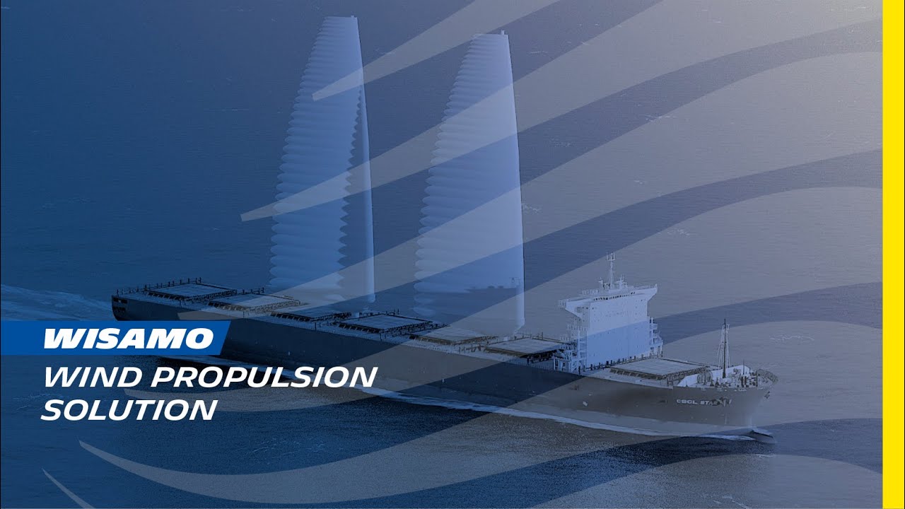

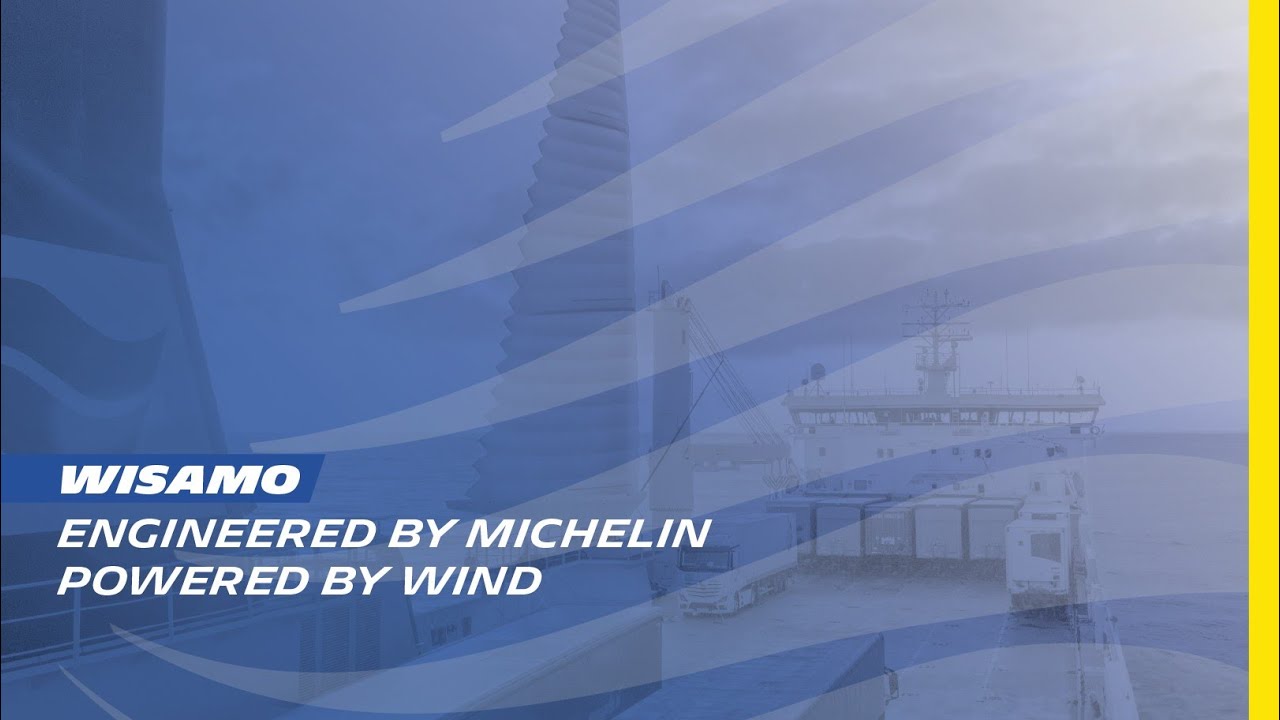

Thanks for that breath of fresh air, Pierre. Looks very nice, good thinking with the telescopic deployment. Are they inflated with air?
Not sure how much it would actually help, considering it is of a similar size to other structures on deck.
The ship operators seem to like the fact that they donât need people from Michelin onboard to operate it (maybe in comparison to kites) and it is capable if staying out of the way of normal operating activities.
The website and another video for additional explains:
INFLATABLE
As the telescopic mast unfolds, the fabric inflates via an integrated fan system. Thanks to our low-pressure technology, the wingsail keeps a completely symmetrical shape, avoiding any wind deformation and effectively absorbing shocks.
TELESCOPIC
A telescopic mast consisting of several segments raises and lowers automatically. Its fully retractable design facilitates loading and unloading operations as well as passage under bridges.
AUTOMATED
A digital control panel allows you to raise or lower the wingsail automatically, without any human action. Sensors detect the wind direction and force to maximize performance and make it completely safe and easy to use.
