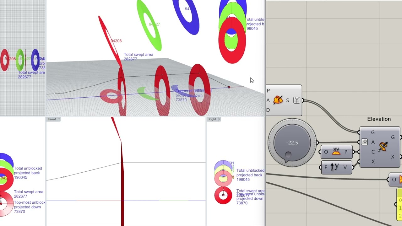

Here’s something which hasn’t been mentioned a lot about Kite Turbine stacking.
They have a weird relationship with cos cubed
Normally in AWES as we increase elevation, we have less disk presented to the wind.
Makes sense, the blades (rotor plane) are tilted.

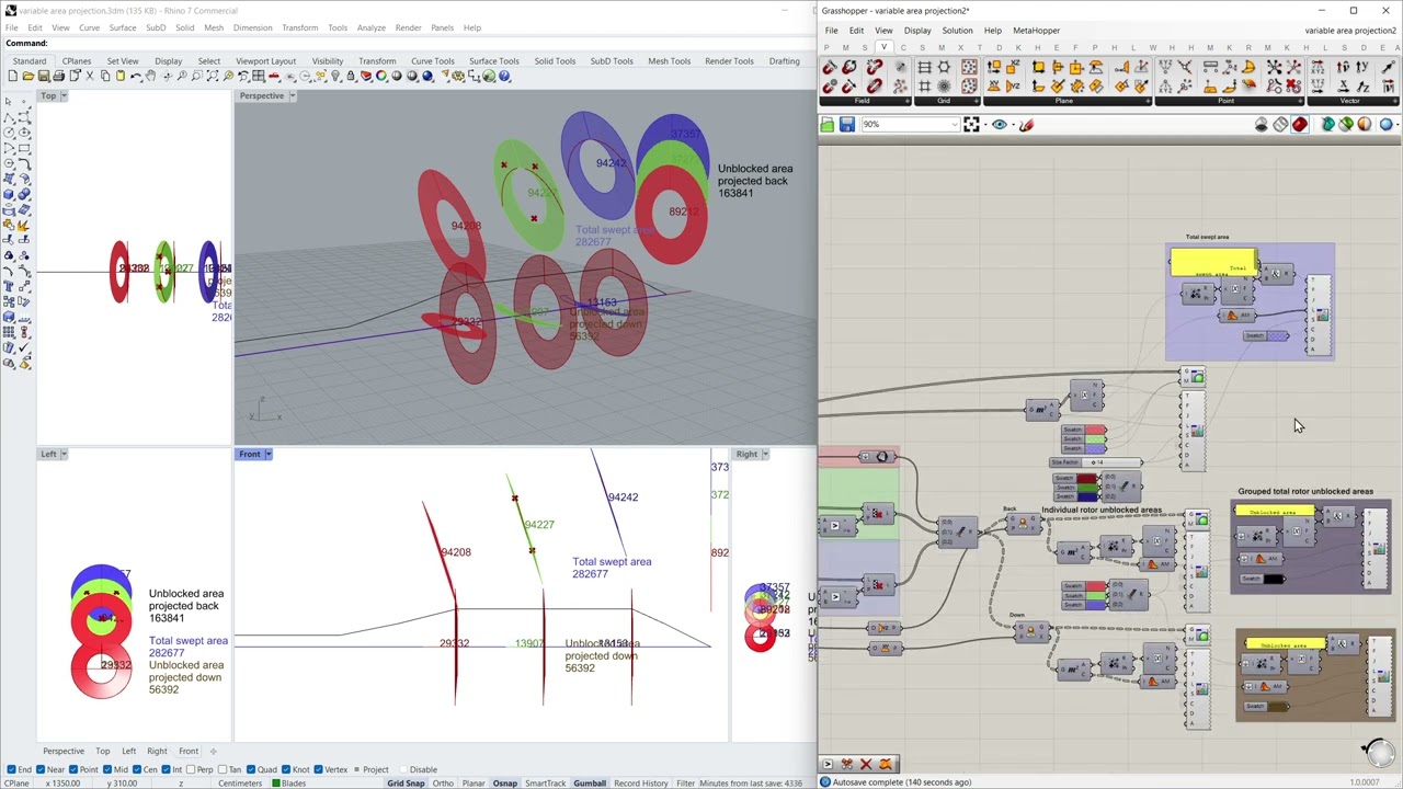

But what happens if you have stacked your rotors one on top of the next…?
At 0 elevation, only the first rotor see clean wind… So we can discount the occluded areas from the downwind rotors.
As we increase the elevation the total amount of rotor disk exposed to the wind increases, up until around 31 ish degrees in this configuration… oh and on review, another maxima grows at higher elevation as the disks uncross
See
There are subtitles to explain what’s going on.
Also
There is a different calculation being done for the occluded areas being projected down (top area only) vs the areas being projected back (full exposure counted) Which system will be better? Why?
If you give a number to the power in an occluded area, you can optimize for power. Anyways look like something that may want to be run through CFD

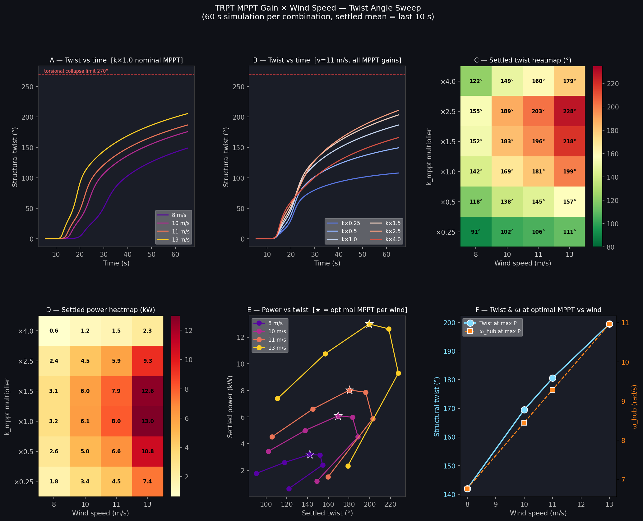

Starting to query the model for twist relationships and different control mppt options
Long way to go
A new report, but clearly there needs to be more consideration of the likes of lift line tension effects… Was run previously on another pc but need to incorporate that soon
