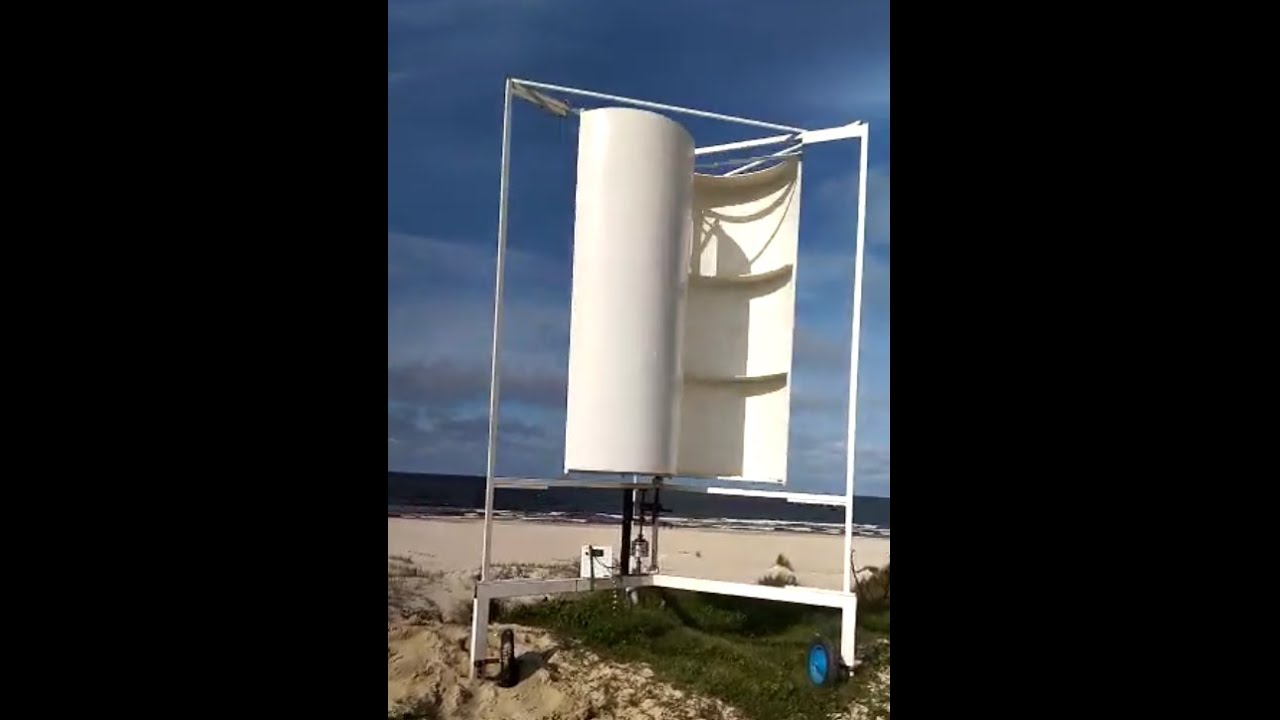

The test seems to be correct and the output is realistic on the following video:
At 0:40, power 19.9 W, wind speed 6.4 m/s (?), area (perhaps about 1 m² if we compare with nearby objects?)?
That could match the values on the Sandia document.

From the data of the video, the Cp could be something like 0.1-0.14, a little less than that specified on the document for the same three-bucket configuration.

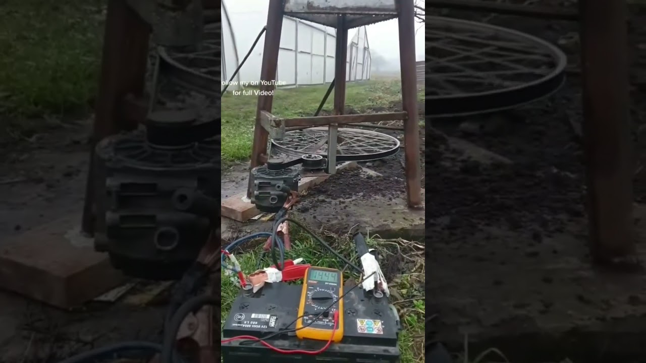

I think the multi-meter measures voltage, but I don’t see amps. So I don’t know the real power (in W).

Yeah, that’s what newbies do - just measure voltage. They get all excited by a volt-meter. “Volts” is something they can understand. They are looking to win the Nobel Prize for producing a voltage. To show current might require, for example, the addition of a more expensive Hall-effect clamp amp-meter.
In this case, they are measuring the voltage of a charged battery, connected to the turbine, indicative of the ability of the turbine to hit a charging voltage, to maintain the charge of a battery. This is known as a “trickle charge”, so with no current shown, it’s impossible to say how much power, if any, is being generated, unless they explode the battery, which would show significant power was being put into it.

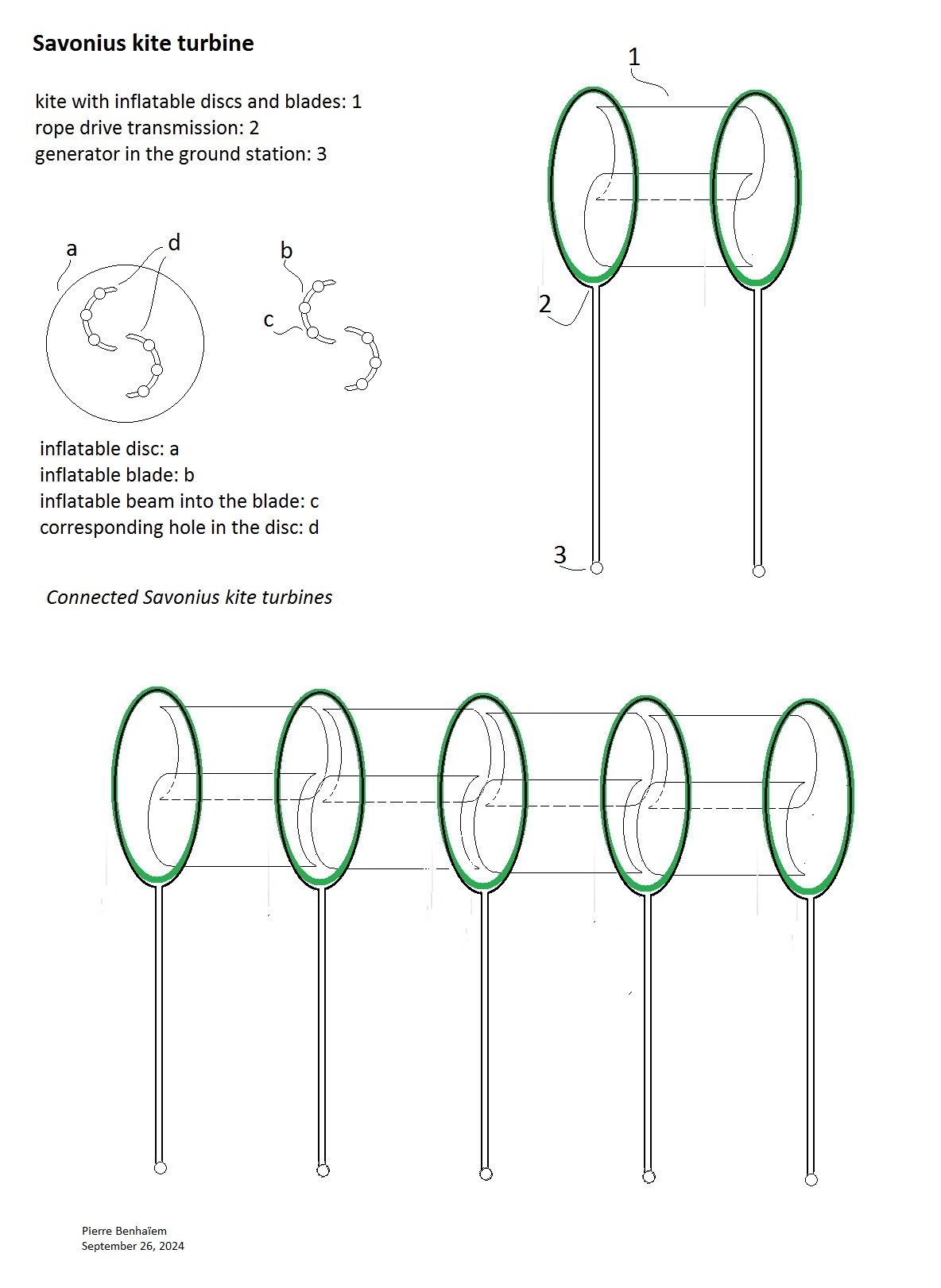

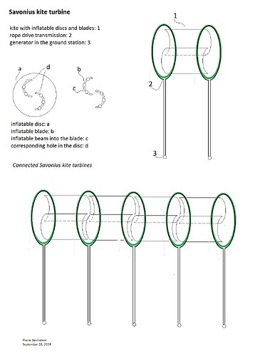

The information from this thread is taken and combined with other interesting information (relatively numerous references) to form a new preprint (yet another one!):
Savonius kite turbine: DOI: 10.13140/RG.2.2.23434.27849
Several scales are aimed. It would be an AWE toy, or an individual AWES, or perhaps for utiity-scale.
Photovoltaic panels could cover what can be covered. The electricity would then be carried by the two cables located at the ends of the rotor and on its axis.
