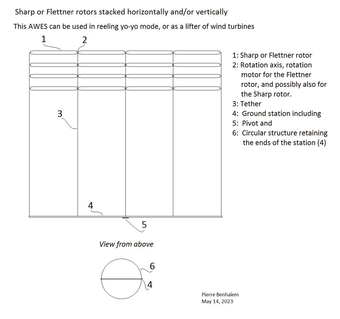

Vertical and horizontal stacks, by adding a guide lifter kite above each column:
If these Sharp rotors include on their respective axes regenerative brakes used to stop or slow down the rotation for the reel-in recovery phase, the recovered energy can be used for lighting, signaling, and powering electronic devices such as sensors, and even speakers for music or for alarm.

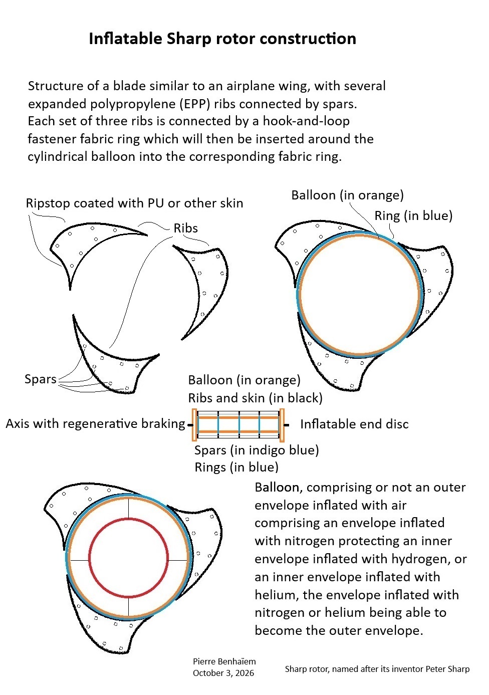

I think I’ve found a solution for an inflatable Sharp rotor.
We can have a central cylindrical balloon whose diameter is roughly two-thirds of the total diameter. We construct each of the three blades separately, like airplane wings, with ribs (made of EPP), spars and skin. We connect them to a self-gripping fabric (Velcro) ring that we insert into the balloon, which is surrounded by the corresponding fabric ring. Self-rotating Magnus effect-based balloon in pumping mode or as a lifter (the end).
Inflatable Sharp rotor construction

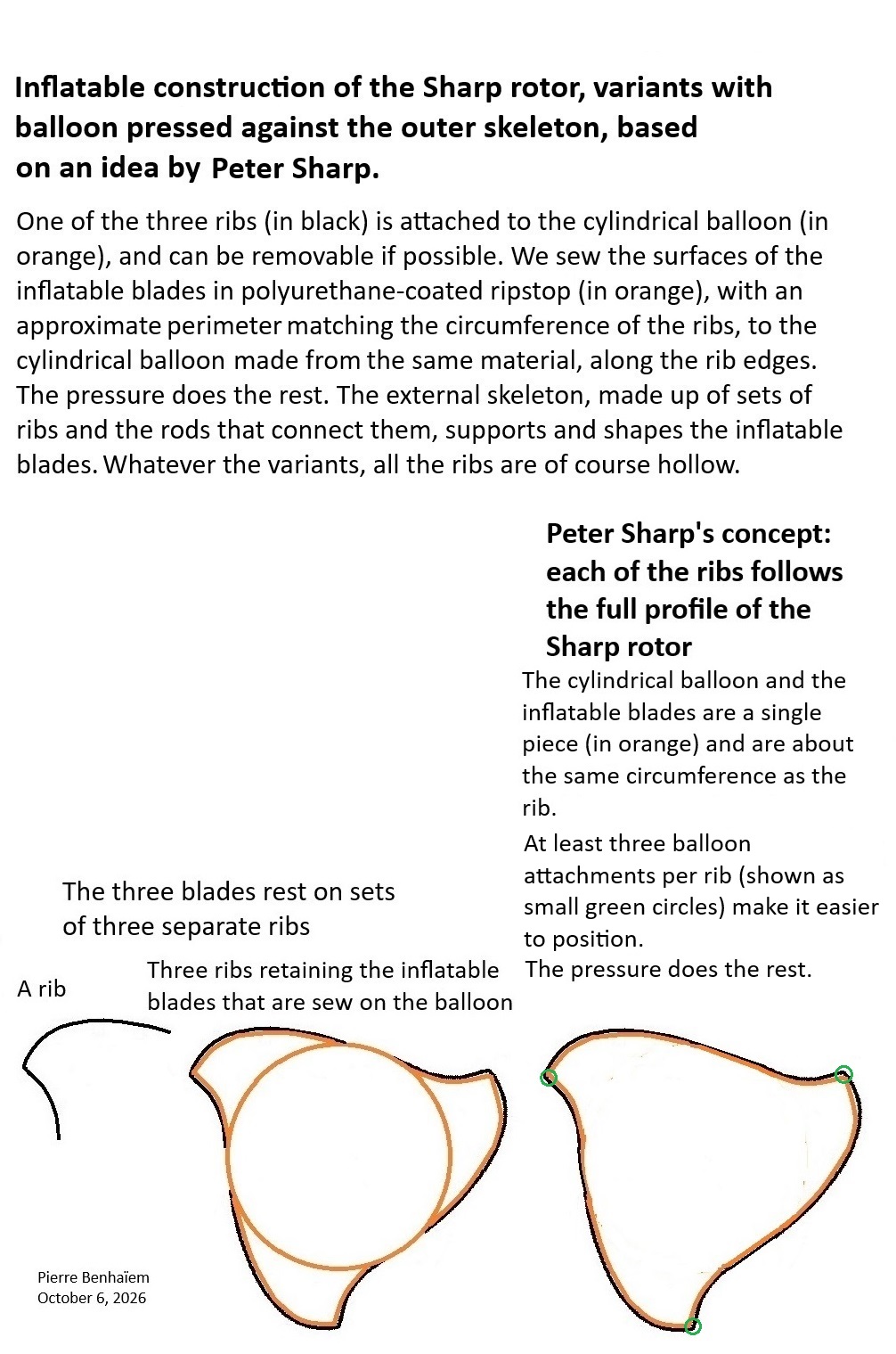

external skeleton and balloon pressed against the skeleton

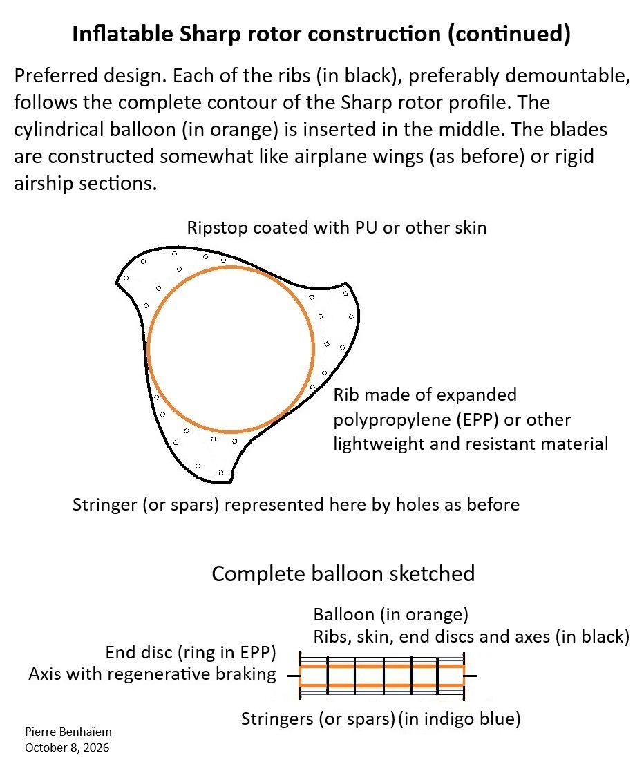

Inflatable Sharp rotor construction (continued)

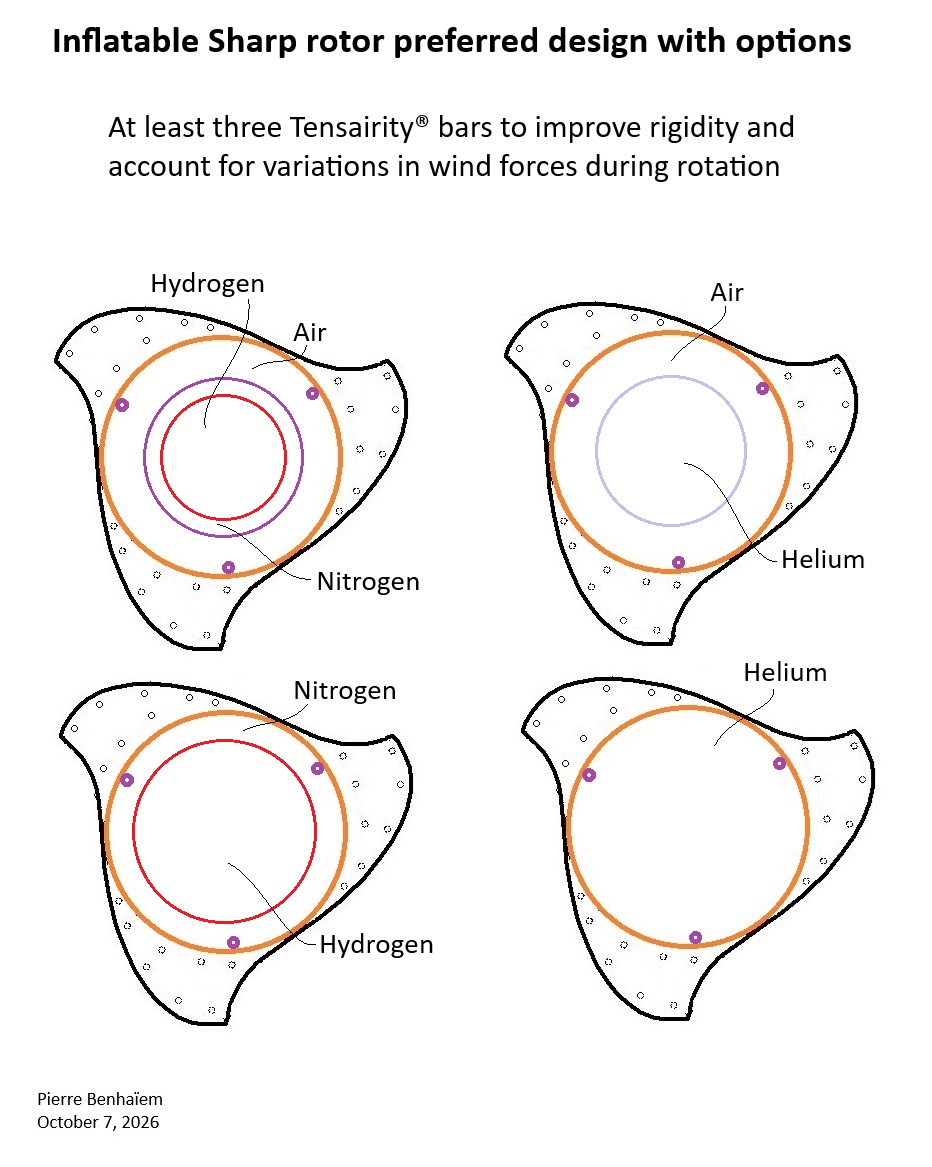

Inflatable Sharp rotor preferred design with options
