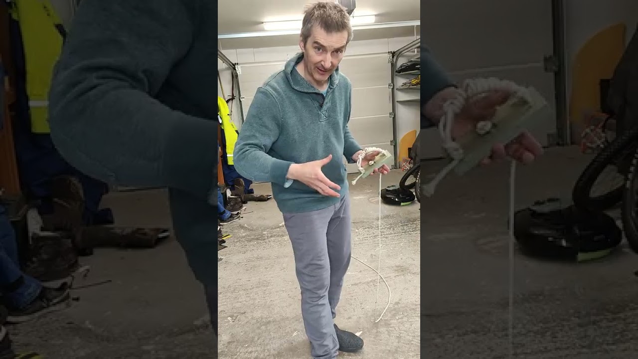

Also of note is that I didn’t exactly demonstrate much by way of torque…
I suppose I could turn my bench around, use the old ground station and start measuring power
Hmmm
I could test the same in the TRPT test rig with two tethers. The result should be similar to a single tether, though my test rig would never run with only a single tether due to balancing and rig stiffness
Have done my initial test with the much increased resistance and size of the ground station.
Had to point the axis very much lower to align with the centre of my arm circle.
I was able to turn the PTO.
Need to recharge my power meter before I can get a reading…
It’s a lot of effort from the kite end to get the PTO to turn… I might need bigger arms. Should have some after a few weeks working out on this machine. Maybe we can have a side hustle making AWES inspired gym equipment
Ohhh man that’s hard work
I only got around 20 Watts out
https://youtube.com/shorts/5JwscU4SgR4?feature=share

I got a new world record
57Watts of pure raw animal power RAAARRRRR
