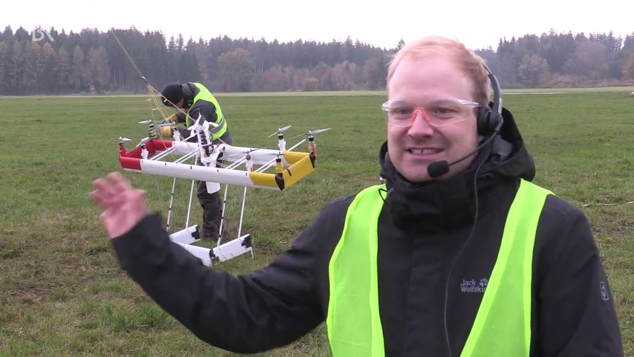

Indeed, and also KiteKRAFT wing http://kitekraft.de/English.html.
I guess my question would be: how could a design deviating so much from a bird or an airplane be the most efficient design. I get a biplane with two wings or a slotted wing, but to me this design seems awkward and prone to low efficiency from the getgo, befor you meet the thousand cuts of design for real life.
Typical sawtooth yoyo curve (see the video at 1:22) with wide figure-eight path leading to various power zones in the flight window: high peak power, low average power during reel-out phase, very low average power during the full cycle also due to the time and the energy consumption during reel-in phase (not shown on the video).
The output data on the screen behind Florians head at ~1:30 on the Kitecraft video is much smoother looking.
Yes their craft has extraneous looking string and struts which maybe haven’t mastered a low tech AWES but they have a very fast acting high tech solution which has to be watched in slow motion to be appreciated.
The KiteKRAFT wing is a flygen. I think the variations on the propeller are more smoothed compared to those of a yo-yo system where the winch more or less stops in each change of direction of the kite as it occurs close to the edge of the window of flight, where the pull is lower. Perhaps a flywheel could smooth better such variations.
