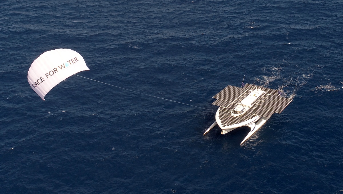

For now it’s just a rendering, but they are confident enough to offer it for sale.
What I’ve been wondering from day-one is, given how kitesurfing or kiteboarding seems to have eclipsed windsurfing with a mast, why don’t we see sailboats and yachts routinely flying kites instead of sails by now? Especially, given the excerpt from that brochure, below"
“By means of dynamic flight maneuvers, e.g. the figure of “8“, SkySails can generate up to 25 x more power per square meter sail area than conventional sails. Thus already the smallest SKS-Y-System can substitute up to 250kW of main engine power with a kite of only 40m² in size in
good wind conditions.”

- Didn’t I just read that Skysails has sold off their boat-towing business to some other marine entity? Are they still using the Skysails name?
- It seems that the whole yacht-kite opportunity has been focused on the same demo solar-powered “walk for water” or whatever the name is, for the 3+ years since the publicity-centric boat began service over 3 years ago.
Hard to imagine people passing up on a 25x power increase, or is there more to the story?
That’s a question I also asked myself.
Probably mostly the compexity of launching larger kite and existing reulation for competition sailing.

Yes we’ve touched on the same possible reasons (excuses?) for several years at this point, but is it possible that it just doesn’t work that well in some way?
Remember the big news about Jeff Bezos’ giant yacht wanting a bridge partially disassembled so the masts of his megayacht could pass through? The big question for me was "Why does it even have a mast in the first place, if kites towing ships works so well? Who wants to heel over when it;s not even necessary? That’s the sort of reason I wonder if there is just something about towing boats with kites that sounds better than it actually is. After all, didn’t Skysails sell off that division?
