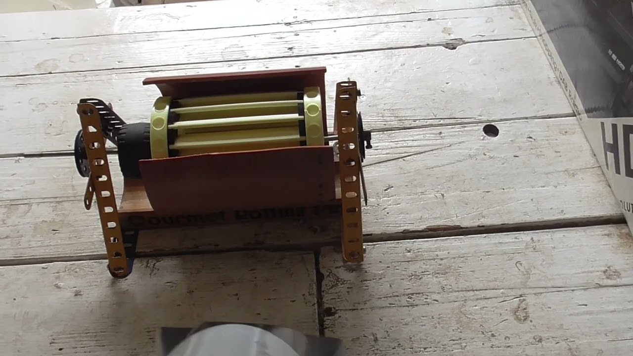

Just thought it impressive that was a pc fan that did it.
Which can be anything from 50 turns to 250 turns. Per coil. As not all fans are made equal. The specs are on a previous vid where he converted the pc fans. I’m going to say it you bog standard fan from a pc before 2018.as there’s plenty on eBay. The point he’s making is some power. is better than no power at all! Just 50% increase is something that not to be sniffed at. One to keep the eyes open for. He knows something which is better than nothing. Different walk, different talk. But hey oh. Bare in mind he converted the fan for power generation. he was doing to show hobbyist how to do the same. He’s making to with the scrap pile. With the bare minimum of tools. Blind he maybe? But with each day of enquiries it get a little less dark.

Go turbine test rig.
Including meccano parts. As the stand.
