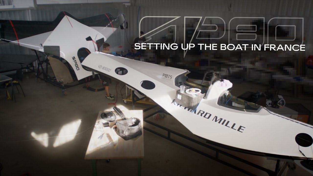

I visited them a few weeks back, but had no chance to see them on the water. They are not planning to fly @Rodread, but planning to sail close to the coast with offshore winds once they have solved other issues and are ready to get rid of other sailors.
