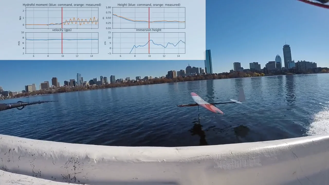

Its a really cool idea that may be scalable to larger scales. But in reality its not that different to a foil sailboat is it? The only difference being that the foil sailboat is generating the lift subsea rather than in air. The foil sailboat on the other hand would have almost unlimited lift in a small package. I know where my R&D money would go…
It’s a shame the demonstration test vehicle didn’t have the vertical sail component.
Getting that mass to rise above the water at starting speeds really does seem easier with a hydrofoil.

The one issue that is not resolved is how to deal with the rolling moment caused by keel and sail. If you want to balance that with ailerons I think there is probably not much moment to spare, and the drag of the plane will be suffering from such a moment
@dougselsam your idea of adding the tether actually solves a lot of the moment issue just like a kite sailboat could have less rolling moment. The moment of the sail is easily fixed by just using the wing rather than a sail on top of a plane.
