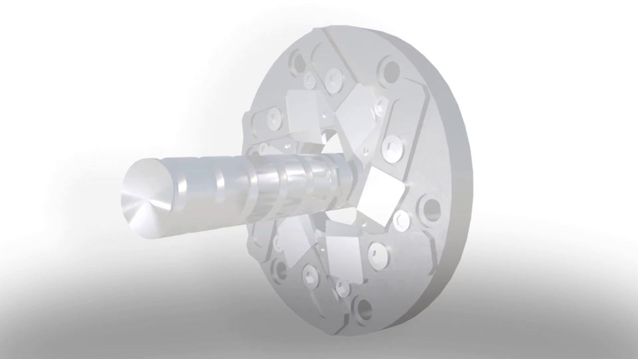

Whirling is such a cool word associated with spinning materials already but
Screw thread manufacturers are using it too
