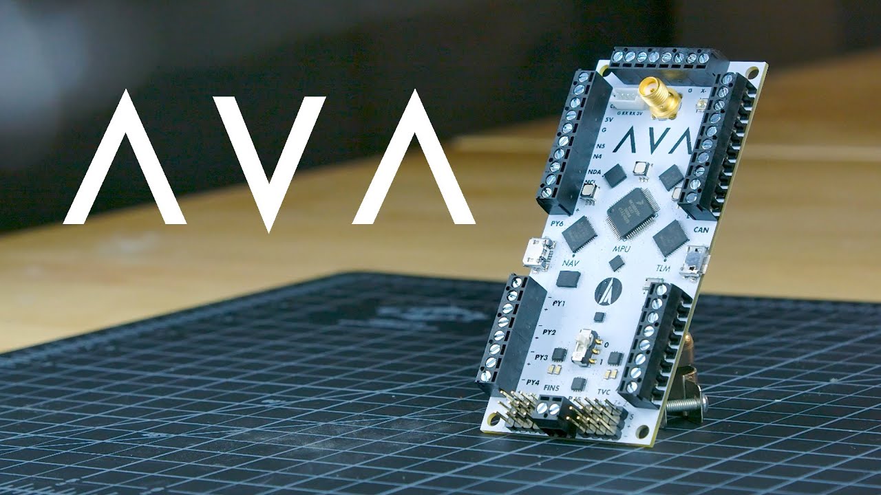

An excellent description of the build of a flight controller for a rocket system
Would be hard to get one ordered, but there are a lot of good hints and tips in here.
More on the project here
amazing dude
The most damnable thing about incorporating this into a kite controller is that @ the end of his presentations he wishes ā€œMay your skies be blue and your winds be lowā€
So wrong
