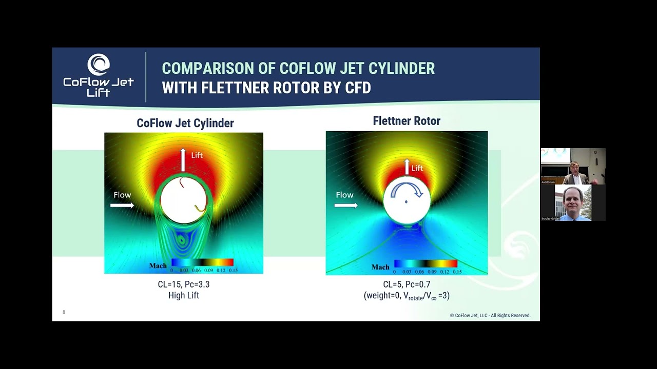

The comparison between the CoFlow Jet (CFJ) cylinder and a Flettner rotor is striking. If the figures given turn out to be achievable (notably a CL of 15 for a Pc (power coefficient or, if I understood correctly, the pump’s consumption power, knowing that it increases exponentially in regard to the increase of the CL, like the power consumption for the rotation of a Flettner rotor) of 3.3, then there could be a possibility for an AWES based on an inflatable cylindrical balloon in pumping mode (vertical trajectory or crosswind) or as a lifter. Moreover, since it’s not rotating, such a cylinder would be easier to handle than a Flettner rotor.
That said, I have not found any accomplishment, even in modeling, whether for boats, tethered kite balloons, or planes, without even talking about a very high CL. So that stays pending.
It is said that the geometry of the airfoil is modified due to the introduction of the CFJ (Co-Flow Jet) within the NACA6421 airfoil, multiplying the drag coefficient (CD) by about 3, assuming the CFJ is not yet actived.
Would the drag penalty be the same for a cylinder, which itself generates a lot of drag without CFJ activation?
