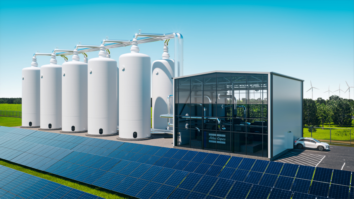

In this topic several storage means could be discussed. There is a topic about gravity storage. Below is a description of a thermal storage:
GridScale offers electrical energy storage of mid-term duration ranging from hours to weeks
The GridScale storage system is an industrialized and scalable technology for cost-effective thermal storage of electric energy. GridScale uses crushed rock as a low cost storage medium and offers high round-trip efficiency with no geological or topological constraints.
https://www.stiesdal.com/wp-content/uploads/2021/11/30883-Stiesdal-Storage-Technologies-brochure.pdf
Reminds me a bit of the same principles.
Yeah sure, we’re so smart we can just move past any details of how we will accomplish AWE, and pretend to effectively hypothesize how we will manage the grid once AWE becomes a major power contributor. Grid storage is really a separate challenge. So far, this sort of hand-waving-and-happy-talk “solution” seems to entail holes in logic and reasoning that would rule them out if fully understood. To me it amounts to idle brainstorming and really just giving up on the stated goal while becoming enticed with a convenient diversion that is probably another false trail.
While lithium batteries are only cost-effective for the supply of energy for short periods of up to four hours, a GridScale electricity storage system will cost effectively support electricity supply for longer periods – up to about a week.
However, the GridScale range covers both the 12-18 h duration required for day-to-day smoothing of solar PV, and the 3 to 7 days duration required for smoothing of wind power over gaps caused by low wind periods.
