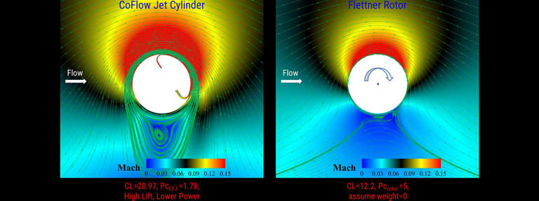

“To achieve this, Zha’s giant cylinder sails would be mounted on the decks of cargo ships. These cylinders would suck in, pressurize, and eject air in different directions, generating ‘thrust,’ or momentum.”
Though Zha has published his research through the University of Miami, his invention is being developed through a startup: CoFlow Jet.
Diagrams compare the movement of air in CoFlow cylinders, versus Flettner Rotors. Photo courtesy of CoFlow Jet
Zha’s cylindrical designs use a twist on the Flettner rotors developed in the 1920s. Flettner rotors are large rotating cylinders that produce thrust at the proper angles when air passes over them. Zha’s cylinders, however, do not rotate.
Rather, the cylinder takes in a small amount of air from the intake, then pressurizes it with a device called an impeller, and then expels the air through an outlet to generate a pressure imbalance.
This creates a substantial amount of thrust and is extended through the full length of the cylinders - which, as a reminder - are several stories tall.
On large cargo ships, Zha said the cylinders could cut fuel consumption by as much as 50% - and by up to 90% on smaller ships.

If co-flow jet technology could give electric aircraft range “on par with conventional aircraft” (@time 0:34), which is a big “if”, then it could also increase the range of conventional aircraft, so “conventional” aircraft would then still enjoy a far superior range. So this one sentence makes no sense in two ways. First, is it really that good, and second, if so, wouldn’t everyone then use it? The wind tunnel test measures only a top wing surface, not what’s going on inside the wing to make it happen, nor the associated opposite forces. Renderings will appear to behave in whatever way is intended. Where’s the real aircraft to prove this? It could be demonstrated and proven at an RC model scale.
I think coflow technology is an interesting addtion to rotating magnus sails which seem to be experiencing at least some success around the world.
I think though that the notion that you can suck air in from an inlet and pump out at a nozzle is a bit farfetched because there are sure to be a lot of losses in the inlet to nozzle path. Maybe a rotating cylinder with fans is a more useful next step? Anyways, I would say this would be money well spent on basic research. If it can transition to an actual ship, time will tell
The CFJ ship sail page says no moving parts which I think must be an exaggeration. Surely they are envisioning som kind if compressor in there? I am also thinking about the amount of air that needs to be moved, and the diameter of the channels in which the air is moving, and how many bends these channels should have…

I think this was already discussed here Co-Flow Jets - #48 by dougselsam. I see more relationship with suction sail (already discussed here Suction Sails) than rotor. I don’t understand the point of having a cylinder, it is probably suboptimal, it would be more appropriate on a wing, with a flap (a bit like bound4blue, but with blowing).
I don’t really trust results when I see negative Cd without a power coefficient given, it is meaningless.
