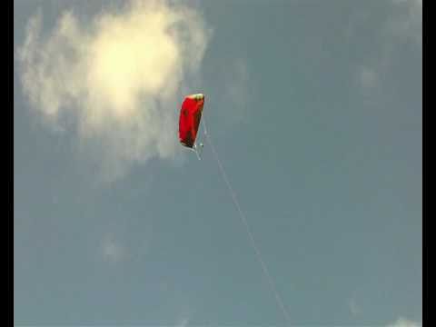

Hi Doug, you speak about the too heavy M600 flying by loops. Earlier smaller prototypes could fly correctly. And the advantage of being able to stop should be considered.
For example my old FlygenKite:
It remains stationary, undergoing a wind speed of 6 m/s (during tests) then flying crosswind at about 20 m/s. This means that with a wind of 20 m/s it only needs to be stationary.
The same for a rigid (and light) flygen system flying at 50 m/s.
