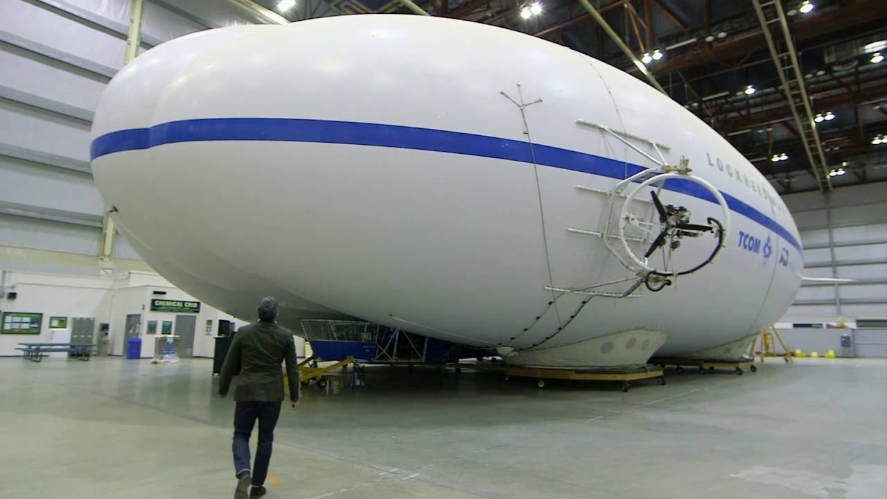

Robotic “spiders” repair holes in hybrid airships.
The Lockheed Martin Skunkworks is famous for creating spy planes like the SR71 Blackbird. The Skunkworks engineers are now working on a new kind of airship. And they have also designed a novel solution for repairing the skin of their airship, robots.

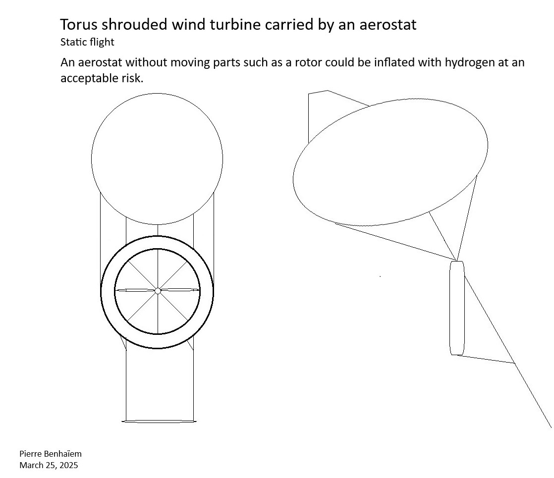

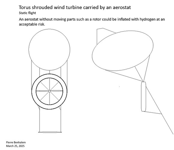

In addition, the hydrogen-filled blimp without moving parts could perhaps be a way to lift a wind turbine by mitigating the risk, as sketched below.

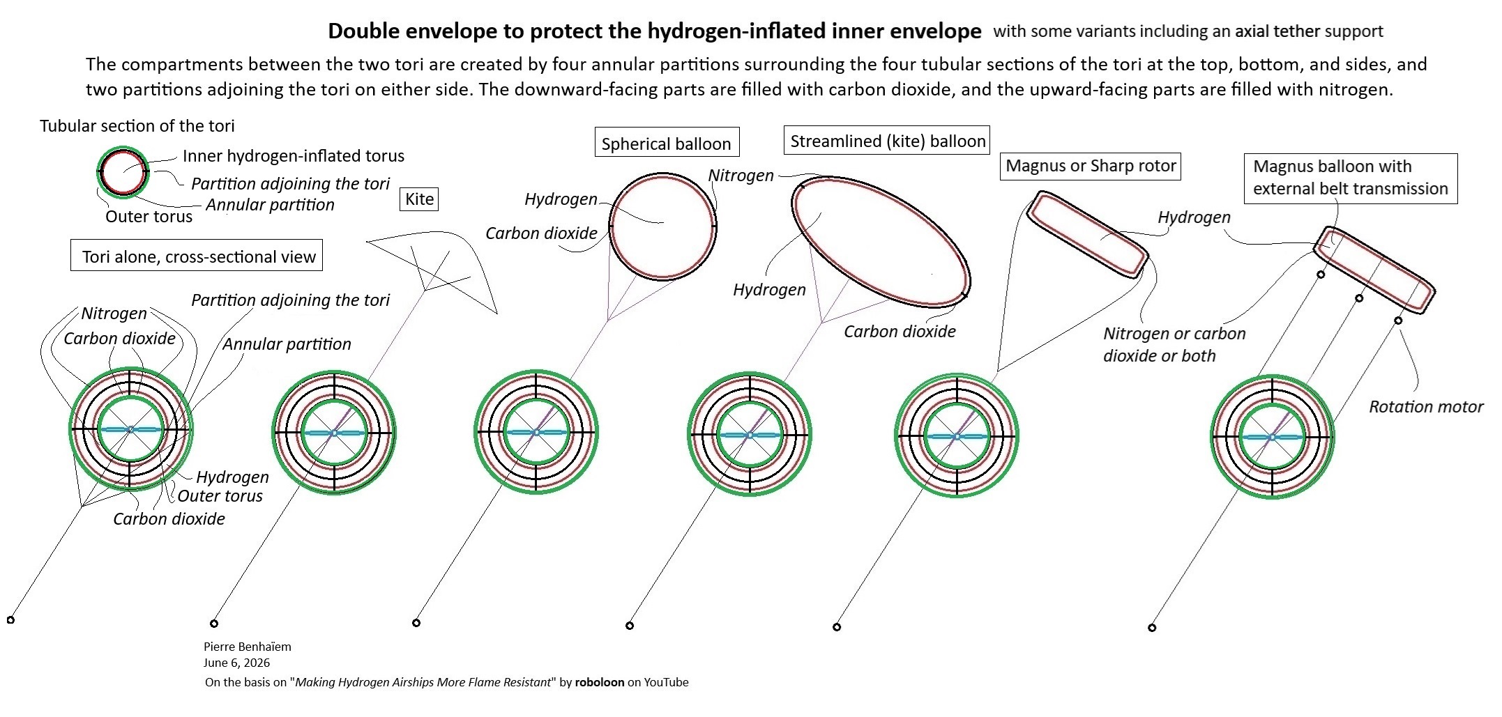

An interesting video, shows how to make a hydrogen-filled balloon less dangerous by installing a second layer around the balloon, inflated with nitrogen on top and carbon dioxide on the bottom. The experiment seems to show that this extinguishes a flame on contact by suffocating it due to the absence of oxygen when the gas escapes.
Test this as an AWES by including a balloon filled with hydrogen, nitrogen, and carbon dioxide while suspending a wind turbine?

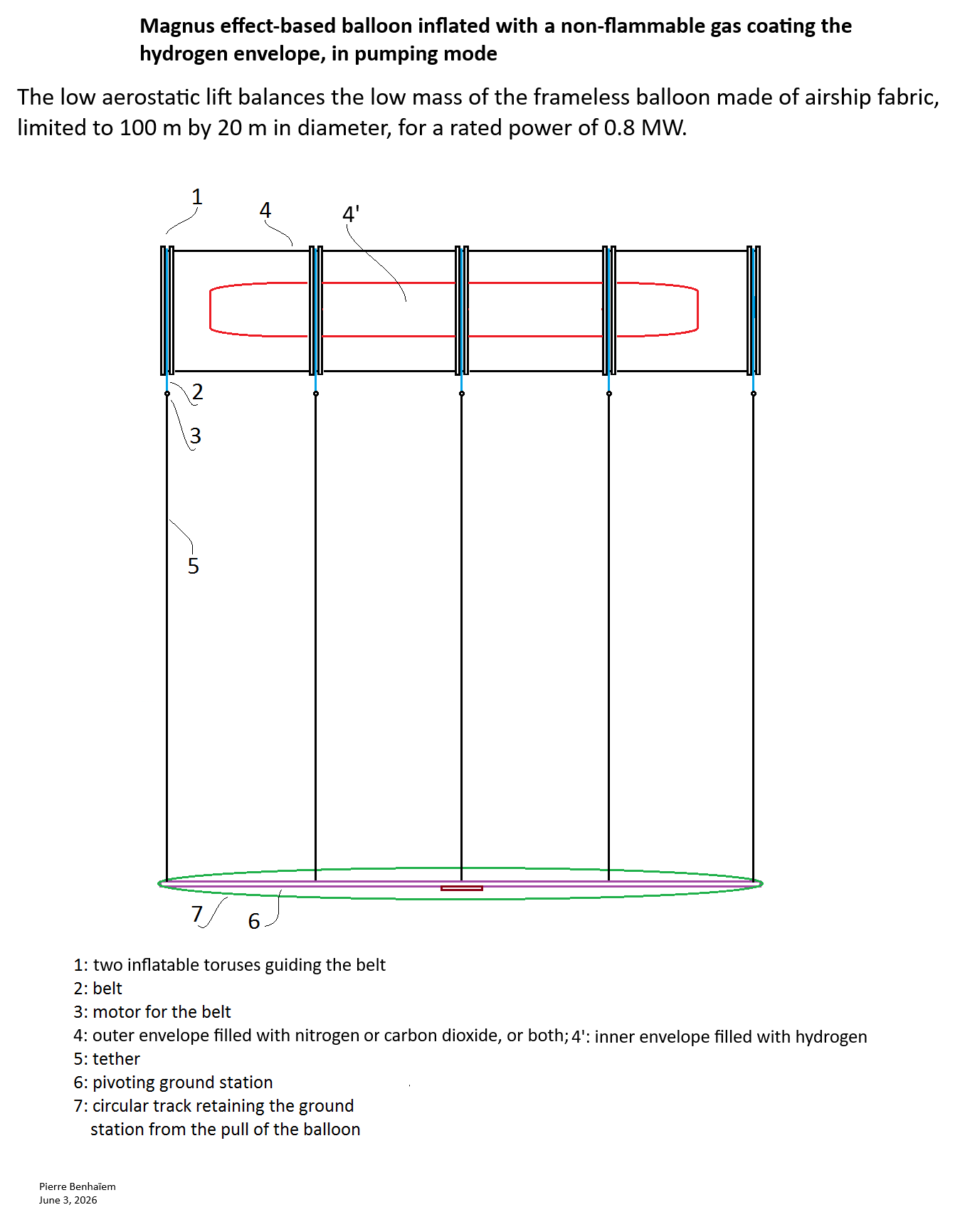

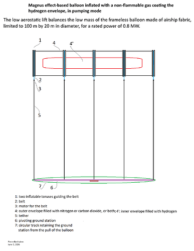

An example on Magnus effect-based balloon inflated with air and helium, or a non-flammable gas coating the hydrogen envelope, in pumping mode or as lifter:

I don’t know if a hydrogen-inflated Magnus effect-based balloon with an external layer of nitrogen would be flame resistant enough, but one can think that the thicker the nitrogen layer, the better the protection, knowing that for the pumping mode the lift should be almost neutral, which implies that the hydrogen-inflated envelope could be relatively small.
