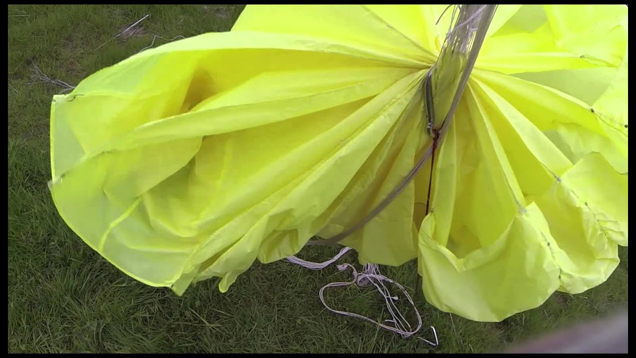

A few years back I did some very cheap experiments with deploying a lift kite from a lifted bag.
A pre lifted kite in a bag can help to launch above calm ground air.
The idea was
Simulating having a drone lift a lightweight kite up to altitude in a sock. When the drone is high enough (and downwind) the kite tether tension is used to pull the bridles and kite out of the sock… This is akin to a fairly standard throw deployment for a ram air or single skin kite or parachute.
The obvious issue with this scheme is that the kite and drone separate so maybe you need a recovery drone manoeuvre, you also need to repack the kite to a launch sock on the ground to restart.

A kite in a sock looks to be a fine solution.
See also how a parasail is launched on (2:30)
