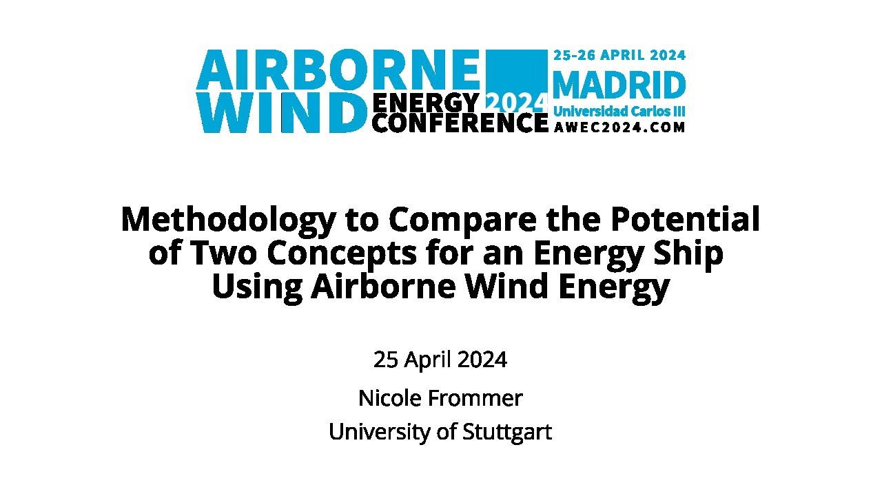

"Methodology to Compare the Potential of Two Concepts for an Energy Ship Using Airborne Wind Energy"
Authors: Nicole Frommer, Po Wen Cheng.
Pumping concept is compared to propulsion concept.
This work was presented in 10th International Airborne Wind Energy Conference (AWEC 2024) in Madrid and is available on the Program (with a link for the video) and the Book of Abstracts | AWEC 2024 page 25.
In the video (at 8:20) there is an indication that “Pumping concept higher mean power than propulsion concept” in the “First results- large kites”; and (at 10:00):“Pumping concept performs better for given parameter space”:
